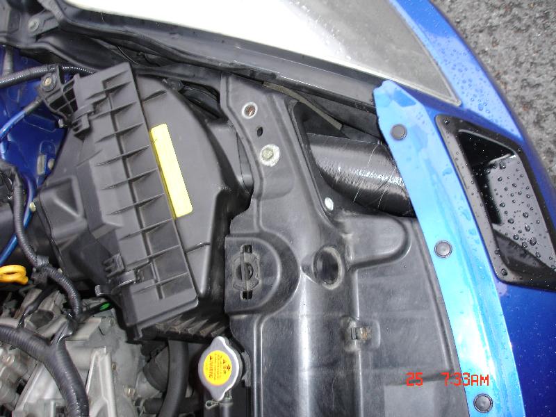

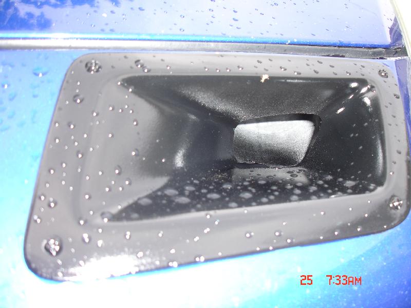

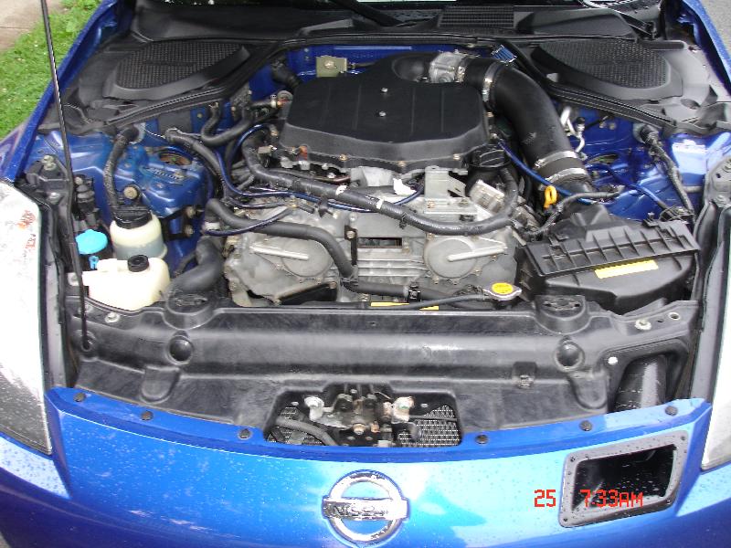

Hey Guys,
Messed around with my Varis intake duct this weekend. Ended up adding a larger hose to run from the back of the duct to the box. Also opened up the hole on the back of the Duct a bit larger.
I have some utec logs of before and after i conected the hose. Once the hose was conected to the Varis duct it lean the car out a good bit.
Here are some pics and the log that shows the car is recieving more air.
Since then, i have retuned the car to be where it was before. I just added more fuel accross the board.
Here are the logs

which column is maf voltage?

Nice, how does it feel up top? What did you tune the A/F ratio after? My car NA ran like a beast at 13:1 across the board...
Old Jun 25, 2007 | 07:53 AM

His AFR's are in the far right column of the logs...
These are very interesting results... The post-varis AFR doesn't really start to lean out until you are in the upper RPM's. Which by that point your MPH's are probably high enough for the effects of the "air ram" to kick in. Very interesting... Thanks for posting.
So you are claiming NO improvement basically?
Last column on the right is the AFR. What i am saying is.
If you compare the top log to the log with the air ram, the air ram side is leaner. The one with out, is what i had the car tuned to prior to the installation.
I since have tuned the car back down to a AFR of around 13.0 and it is running real strong.
It seems that i am recieve more air by my AFR going leaner with the addition of the hose.
What do you guys think?
