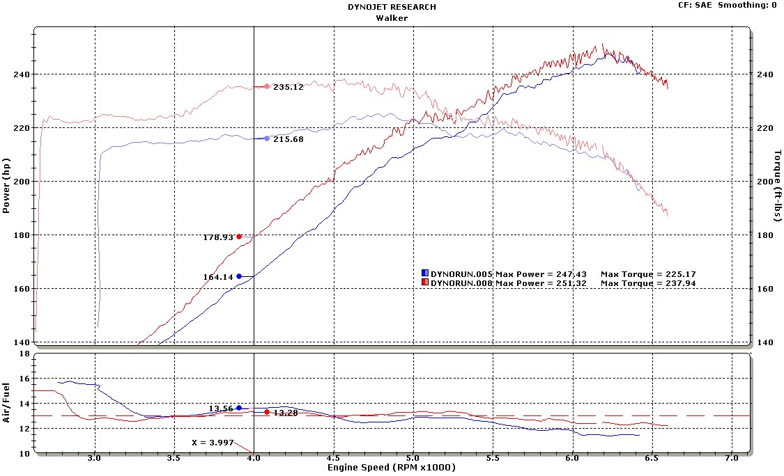

I installed mine. And here is the before and after dyno make up your own mind.
I would do it over again....and no I did not have cams.

but we know from your previous posts that the headers were not the only thing you redyno'd with, nor is it clear if did you do it on the same day. I just don't like seeing people go down a particular road of mods and stock part on top of part seeking to achieve something "elusive". There are definitive ways to make NA power on these cars - headers are a key component to making true NA power, but by themselves, they are not an answer, nor even something I'd recommend. Given the stock lift and overlap of the stock cams coupled with the way stock heads flow, it would take a very different kind of header to truly make a difference. To date, I know of 1 such header (Crawford) and as good as it is, it's also a total pain to install. Again, I'm not saying that headers don't give a gain, they do. But the install is not simple, and on some designs (the better ones), it's nothing short of a royal PIA. So given those factors, I am personally of the opinion that they are not worth doing as a standalone mod.

Same dyno three days apart
The dyno run 5
outside temp 79
jwt popcharger
5/16th spacer
mild port and polish
nismo exhaust
The dyno run 8
temp 90
JWT popcharger
5/16th spacer
headers
nismo exhaust
The only change was worse temps and the aem cai and headers. The aem is proven to dyno lower than the JWT popcharger. So I credit the HP and TQ to the headers. The charge is to great to say it is just a difference in 3 days.

and that's exactly my point
you changed headers, and ported and polished (even mild can have a significant change), and did it all on separate days (helps that its the same dyno, but still not a definitive answer as to "yes these worked". So, not exactly a standalone change, so who knows where your gains came from. I won't even consider the intake, as none of them are going to do anything dramatically different than another. I read what you paid for your headers and that you did the install yourself - at that point, it could very well be worth it for you. But for someone paying more traditional retail prices and then having to pay someone to install them, you can see where it gets very expensive for minimal gains at best, as a standalone mod
