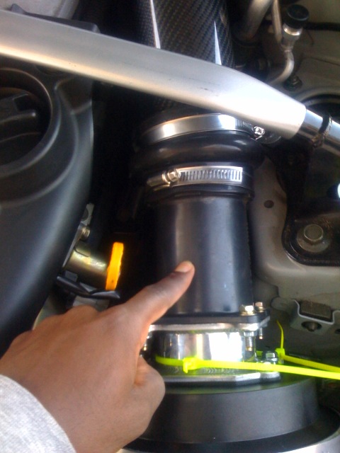

thanks for the reply whoopazz.
I'm pretty sure the MAF opening is facing the right way as one side of the MAF tube has the bolts to secure it (which should be facing the front bumper) and the other side just slides into the rubber grommet into the intake tube correct?
I've attached a pic from a different forum member to show you what i'm talking about.

Old Aug 14, 2008 | 09:01 PM
whoopazz1's Avatar
whoopazz1
Posts: 323
From: Canada, E-Town
Yes that should be good then... try spraying it with some MAF cleaner... I'v read that somewhere as well... might have cought some debris...
