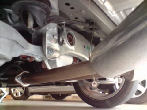

Hey guys,
Ive been hearing a rattle/bad rasp in the 2k range, so I decided to go under the car and see if anything was wrong. While I was down there, from behind the car where the heat shield is and my hks mufflers, I saw a circle thing hanging from the car. The "string" or metal "string" is maybe 6 inches long and at the end is a circle, almost like a round nut. Wondering what that was and why it is dangling. I will have pics up in a little bit, thought maybe someone might know without any pics. Thanks.

uploaded a pic

Ground strap that went to your OEM exhaust. Whoever installed the aftermarket one didn't bother to hook it up.

so where should I hook that up to? Any bolt on the heat shield?

TP cause the rasp. The ground is connected to one of the bolts that hold your OEM muffler to the midpipe.

Easy to snip with wire cutters.

^^ I was thinking of doing that, but didnt know if it would be harmful or not. I mean, its gotta be there for a reason, for grounding. I think I will just bolt it when I reinstall the exhaust.
