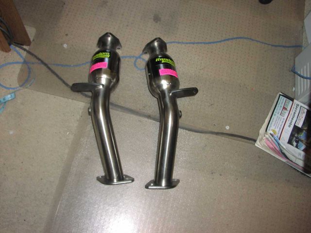

So then here are my plans:
1. Install the RT's.
2. Put 200 miles on them off boost.
3. Go to Motor Sports Dynamics and have them do a (gasp) Dyno and A/F test with wideband right here in Sacramento.
The owner Henry is highly respected and actually had lunch with Tadishi of Technosquare at SEMA the other week. If I am too lean I will then schedule an app. and drive down to LA and reflash. Hopefully I will come out ok (plus I will finnaly have a dyno number for my sig.)
It seems like there is too many variables etc and I have come along way. It is worth it (peice of mind) tto do this final step and be finished (except for my Edge Racing Converter and B&M tranny cooler.)
So of course I will have pics and updates soon for all.

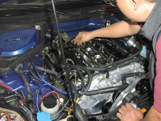

Tadashi at TechnoSquare says the cars with the RT hi-flow cats run lean. He took out one of my spark plugs and the top of the threads was black. It was running very lean. You should watch out for that. The TS ECU flash solves that problem.
