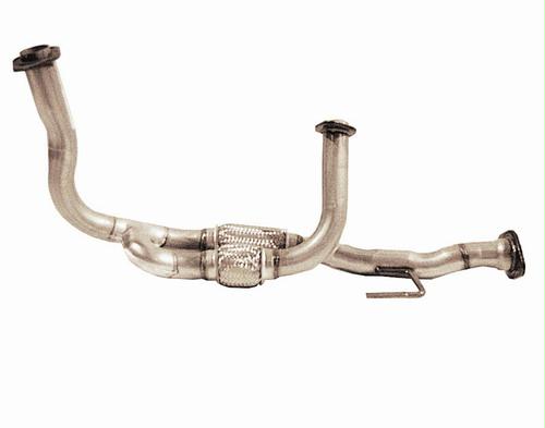

its the mesh part in the picture

llol no of your car, we know what the flex pipe looks like but the dammage, and is that part off a subaru.....

duhh im just sayn picture that part scratched up lol it doint matter if it came off a farrari i just wanna know can they be repaired if they are scratched or do they need to be replaced

A portion of the test pipe is damaged? Of course you replace the entire pipe. You may find someone who will fix the pipe at $80/hour plus parts. This is hardly economical.

Possibly the flex pipe can repaired.If not,the "y" pipe that you are referring may be able to be ordered.I'd check some companies that specialize in used Z parts.
I recently had a NISMO cat back installed at Z-1 Performance near Atlanta.They have my OEM system and many other used Z parts in stock.I'd buy that section rather than try a repair.Or,a whole OEM used system are pretty cheap.
Give Z-1 a shout.

I guess you could cut the flex pipes off the torn y-pipe and weld some new ones on???
other than that, replace the y-pipe. Theyre relatively cheap. And you must have hit that curb pretty damn hard to tear both.
And pictures of the damage on YOUR car, would be helpful.
