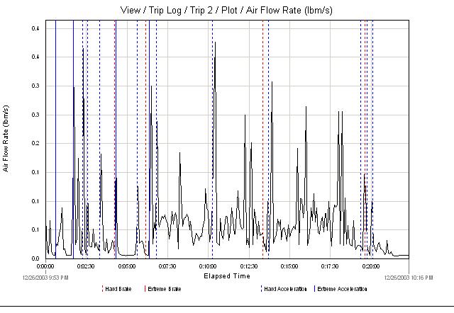

I did a comparison of the Nismo Intake, stock intake, injen and JWT intakes with a "car chip" that records ait intake temp, air flow, etc. and found that the intake that allows the most air flow is the JWT popcharger, then the stock set up, then Injen & Nismo.
As far as air temps I only have numbers comparing the Nismo and stock set up. The difference was only 2-3 degress colder air for the Nismo set up (avg. over an 12 mile run), but with less volume of air.
I don't know how accurate the "Car Chip" is, so these numbers could mean nothig at all, so take it as it is. I personally feel that this little experiment has some basis to it since the data was recorded off of the ECU itself, but who knows?
And yes, I do have all these intakes.
Craford Plenum air flow rate blew away all of the above.

pic of graph with Crawford Plenum and JWT pop charger air flow rate.

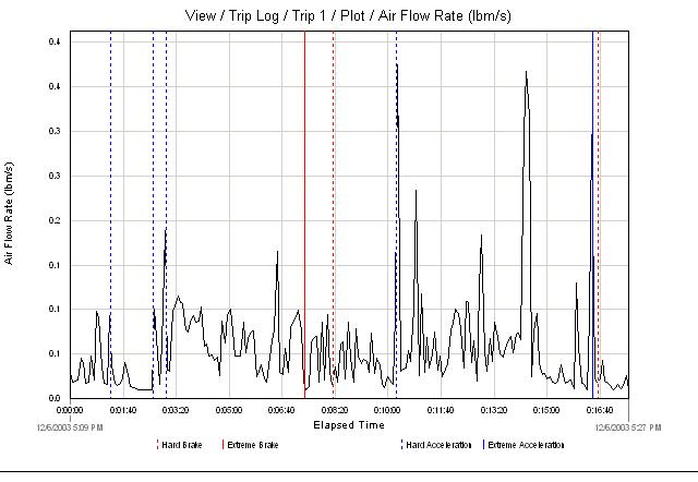

Stock intake graph

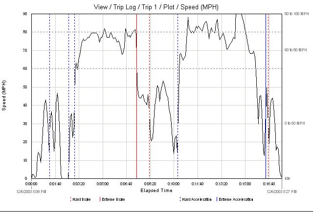

speed, on closed track of course

It seems like CAIs will show more gain on a dyno, with relativly static air, than the stock/pop charger. But the tides turn when there is actual ram air applied. It's cool to see how these mods perform during real driving conditions. Thanks for the info!

Alex's data above isn't from a dyno, its from autotap, which reads your ecu while driving. I think his comparison is the best we can get, and appreciate the info.
