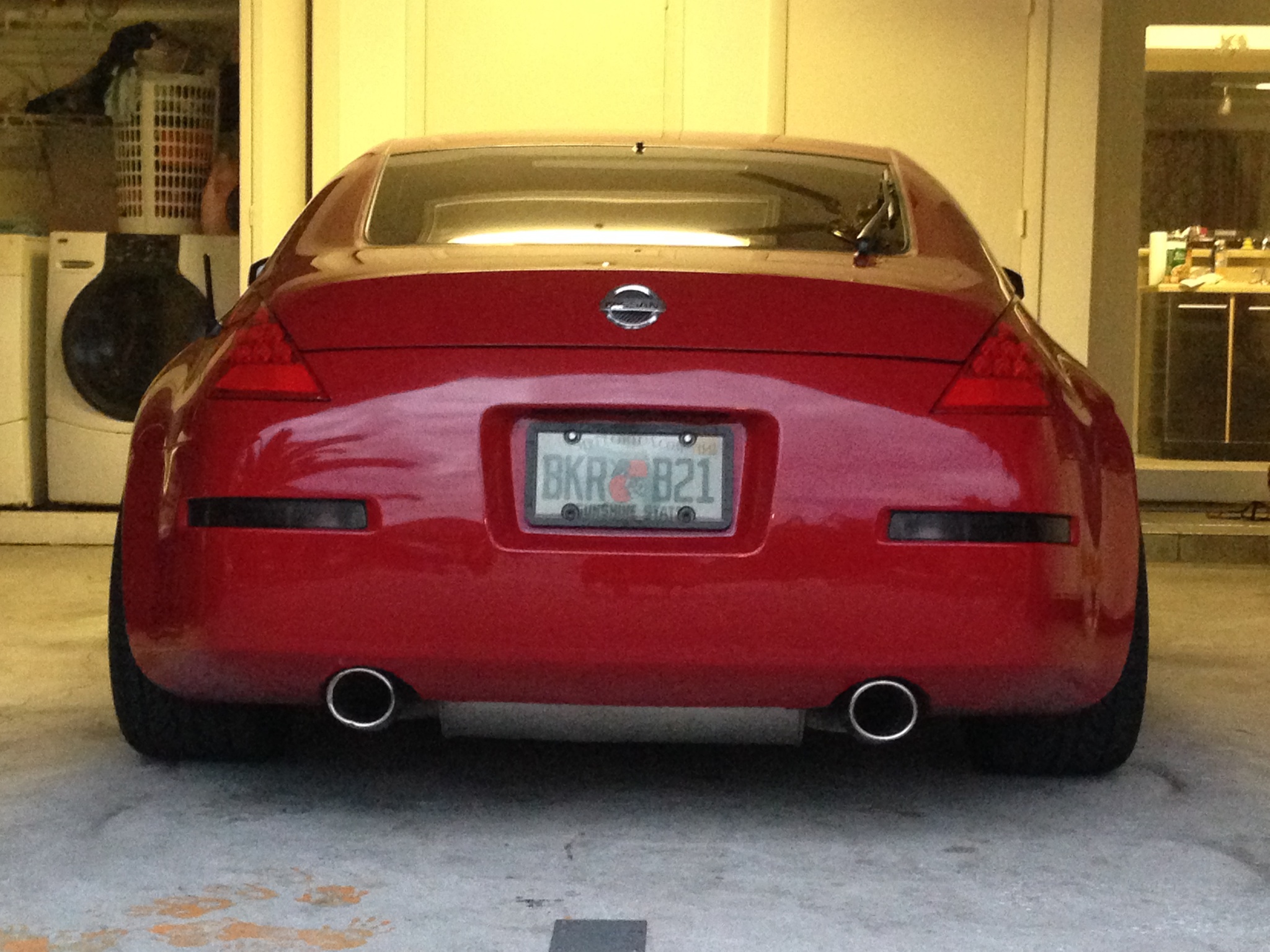

Installed it over the weekend, one of my cats has a hole in it which is why it always sounded weird you can still kinda hear it after the new exhaust.. Idk Test pipes or high flow cats next? Which is better?Any specific brand? Don't have much experience with them
