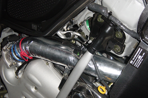

I love mine. Good mod. Now that I have heat wrap the pipings also, I might get more out of it. Updated pix
No, I dont have the part number. But I think there are only one Typhoon Carbon intake for 350z?

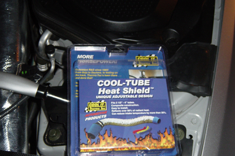

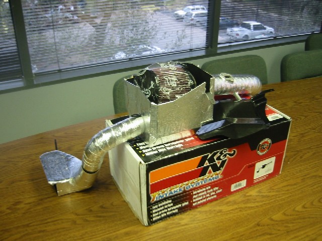

Here is what I used on mine- made by a company called ThermoTec. Specifically made to fit CAI piping- Mfr p/n is 14500. You can get it on Summit for about $38. We hooked my car up to a device similar to Pocketlogger and saw temps drop between 15-20 degrees (in 75 degree weather).
Attached Thumbnails Heat Wrapped K&N Typhoon Carbon Box Intake *Pix*-dsc01306.jpg

2.
Attached Thumbnails Heat Wrapped K&N Typhoon Carbon Box Intake *Pix*-dsc01303.jpg

3.
Attached Thumbnails Heat Wrapped K&N Typhoon Carbon Box Intake *Pix*-dsc01304.jpg

Yes it will. The adge of the top carbon cover stands out about 1/2" from the box, so any water coming on top will not get into the gap. Not only that, the ram air piping is not directly connected to the box. Its got an inch gap bewteen the tip and the box, so water coming in from the ram pipe can drain out before it hits the box.

looks good... did you wrap it around the pipe just once? or did you to it in layers? wouldn't help if i'm using the stock plastic pip huh? was planning to get the pop charger, but this set up looks good. How much and where?

Yeah, I just wrapped it once. But they do overlap eachother tho. I dont think you need to wrap the stock plastic pipe, it will be hard cuz its uneven anyways. You can get them from Jason...cheap!

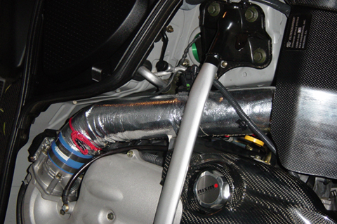

I paid 229 for mine form hopupracing.com. No shipping charges no tax. I got the heat sheilding from summitracing.com. That ran 80 bucks. Get two big rolls of tape and 2 sheets. It takes at least 12 days for the intake to arrive because its coming from the factory to your door step.
my reveiw: Its an awsome intake. Sounds loud at 5K RPMS after 1st gear and keeps getting louder and louder. I am satisfied. I originally was going to get the popcharger; and actually I bought both and sold pop charger to my friend.
Only thing I dont like. 1 thing. It uses the hole for the toeing screw as a mounting plate for the bottom piping. So if you ever need to toe the car your going to have to remove the air intake piping. BIG SUCK!
Attached Thumbnails Heat Wrapped K&N Typhoon Carbon Box Intake *Pix*-pimg_3748.jpg

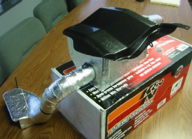

one more veiw of it.
Attached Thumbnails Heat Wrapped K&N Typhoon Carbon Box Intake *Pix*-pimg_3742.jpg

wow...nice. You did a better job wrapping that I did!
