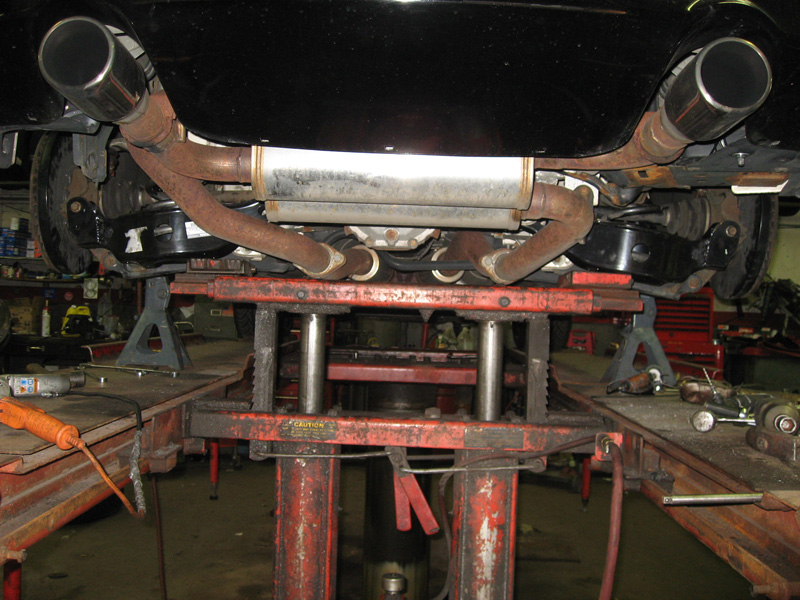

That's what I was hoping for. However, I saw this picture of the Stillen exhaust, which also uses 304 stainless steel, and then decided to maybe take some preventative measures.

I remember seeing that. I think that was just a freak thing. Trust me just do what I said and you are good.
