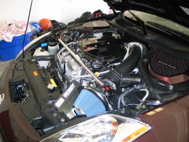

Here is picture of engine set-up
Attached Thumbnails R/T Cats DESTROYED!  *PICS showing the disaster*-arkansas-blast-002.jpg

is that V5 CF ?

Nope
