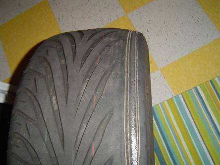

Well it's been a while since I've been on the forums, but I've got a quick question though - and I'm pretty sure this is obvous, but still wanted to double-check.
As you can see from the pics below, the inside track (front tires, Toyo T1-S 245/35/19's) of my tires are completely worn down to the metal. So first thing I thought is - Front cambit kit time. I have Volk LE-37T's, and dropped 1.25" on espelir springs. Otherwise, no suspension mods (even though I have had two alignments done) But obviously, the front tires were worn out very fast -- my two rear tires have been holding up just fine.
My question is - is this tire feathering? Or is there something else that is wearing away at my tires? Some other people who looked at it also thought I need to get Front Arm adjustments too, but I just wanted to make sure that's what would solve this problem.
Any advice or suggestions would be greatly appreciated.
I've mixed reviews on several kits, but as of now (because I doubt I can afford the 350evo or stillen kits) I'm leaning toward the Kinetix front upper arms.
Thanks in advance,
drew

pic 1 - sorry it's kinda blurry

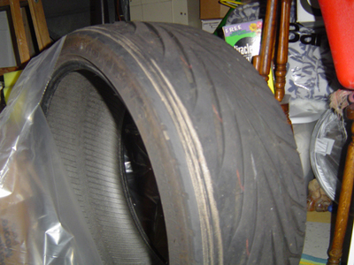

pic 2
metal wiring = not good sign

If you dropped your car 1.25", then you need the camber kit.. no questions..
