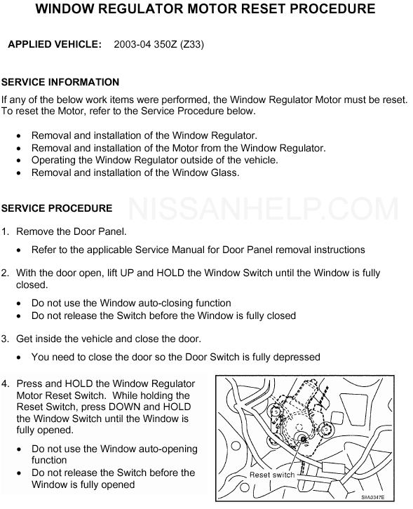

I got my 04 z a few weeks ago with about 18k on it, and brand new tires! But on the test drive the driver's side window took a phat dump, of course the dealer fixed it. But today the damn pass. side one quit working (at least the window is stuck up and not down!) Anyways just wondering if my car is a lemon or is it a common problem?

You checked the window lock switch on the drivers door? It will disable both switches.

You may just need to get the window motor reset if that doesn't fix it.

yeah the switch is unlocked, guess i'll have to go to the delaership and be without my baby for a day or two, or three ,or damn that sucks!

Here is the procedure to reset the window if you want to try it yourself.
