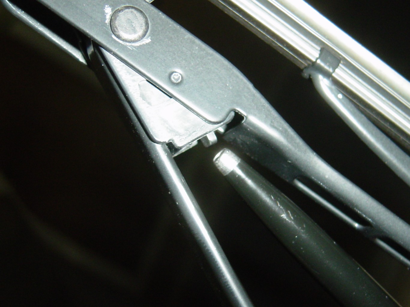

just to clarify this a little bit, ive got the actual blade off but i want to replace teh whole assembly and it doenst seem to just pop off.

Page 8-20 of the Owner's Manual says,
1) Pull the wiper arm
2) Push the lock pin, then remove the wiper blade.
3) Insert the new wiper blade to the wiper arm until a click sounds.
There are pictures on this page that may help as well.
Not sure if this is exactly what you are looking for but hopefully this helps.

In the photo I have a silver tipped black pen pointing to a small tab. Push that tab toward the driver's side of the car, hold, and slide the entire wiper assembly to the windshield.
Pay attention to your new wipers!. They may not unlock so easily. Just note their mechanism before attaching to the car.
