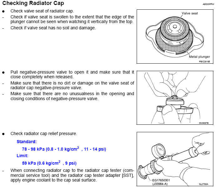

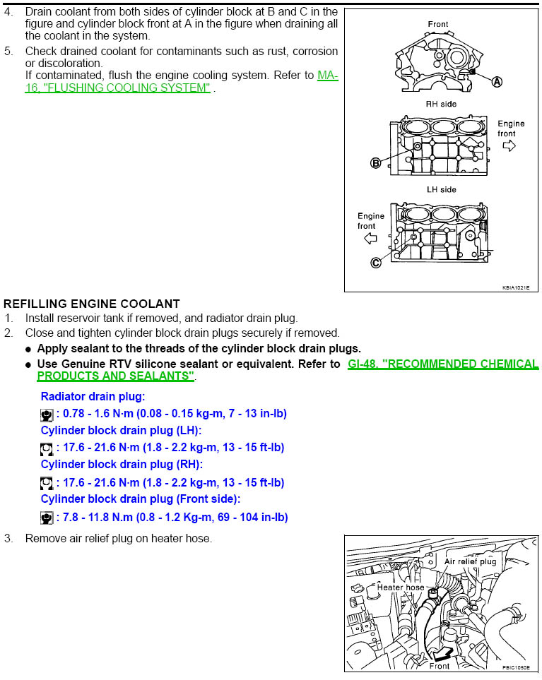

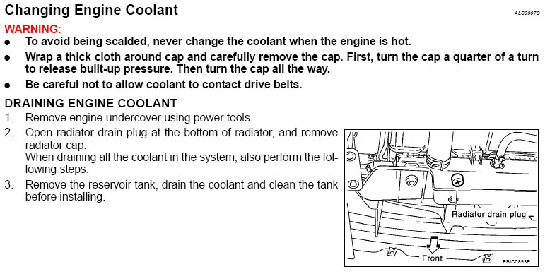

Here it is.
Attached Thumbnails DYI Coolant fluid flush?-350z-coolant-change-1.jpg   DYI Coolant fluid flush?-350z-coolant-change-2.jpg   DYI Coolant fluid flush?-350z-coolant-change-3.jpg   DYI Coolant fluid flush?-350z-checking-radiator-cap.jpg

Originally Posted by 03aeroZ
^where is that from?
Service Manual
