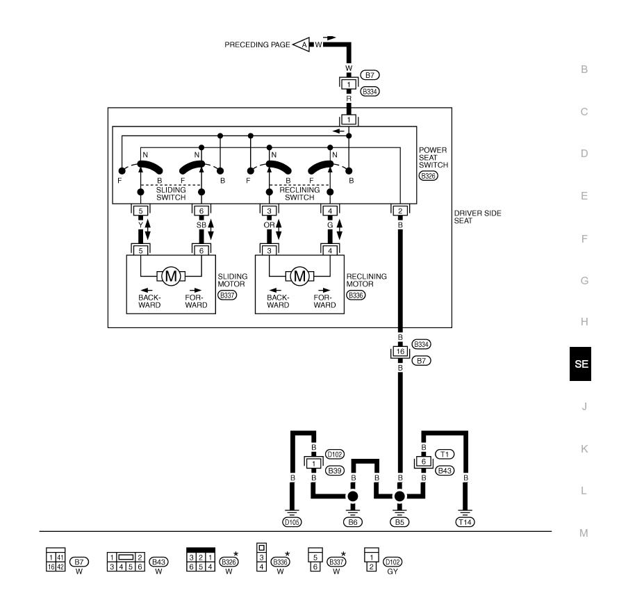

OK i found the POwer seat diagram all you have to do is leave the switch connected because it has the ground source on it and all you do is apply power to pin #4 which is green and that bring it up...just make sure you have power coming in from PIN #1 Red wire...OHH BTW power is supplied thru the Body control module and there is no seperate FUSE>>>

having same problem now, have dismantled switch, need small thin rachet with phillps head sockets to reach two screws facing console, bought at pep boys and a lot of patience in unsnapping the switch housing which has several components snap locked together. I did this in place and wonder if not easier if I had taken seat out. Switch harness is locked inplace with clip so not much slack in wire to work with when working inplace.
Problem is that the exposed push/pull lever switch is only first of series of movements that must function to engage the electrical connection. Below the exposed push/pull lever is a secondary sliding switch which is operated by small arms of the exposed push/pull switch. These arms do not seem to be pushing the sliding switch far enough into position( the rear recline or pull back works but the forward position will not) This is because the secondary switch has two small sliding switches housed within the one switch. It may be that the receiving end nodes on the small sliding switch are worn which pushes the sliding mechanism to make the connection . When dismantled, operation of the recline back or forward small switches is easily done with the finger which is what I have done. Dismantle, move back of seat way forward , assemble, get in and start moving set back a little at a time, cautious not to go back to far (this small sliding secondary switch seems to small to work on but seems to be able to be taken apart ).
Probably took two hours the first time but after getting right rachet tool and knowing how two use two small screw drivers a once to unsnap the switch housing, it has become easier.
Just priced switch with harness $70.00.
Probably worth it cause it is a headache to dismantle inplace and probably easier to take seat out to replace. Go to DIY to find this proceedure
