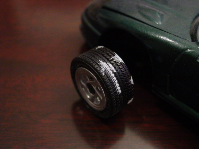

Allow me to demonstrate with my Dodge Stealth TT model.
I have marked the feathering with white out and the arrow depicts the rotational direction of the tire.
I have removed the wheel from the front drivers side of the car:
Attached Thumbnails My Tire Feathering 'fix' from dealer. Please help Me!-tires-001.jpg

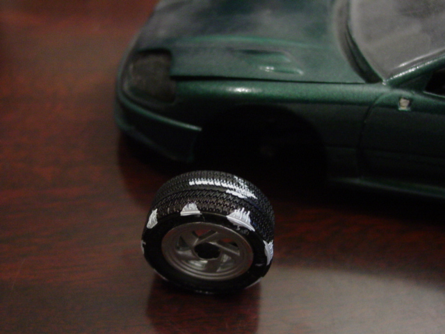

The tire is removed from the wheel:
Attached Thumbnails My Tire Feathering 'fix' from dealer. Please help Me!-tires-002.jpg

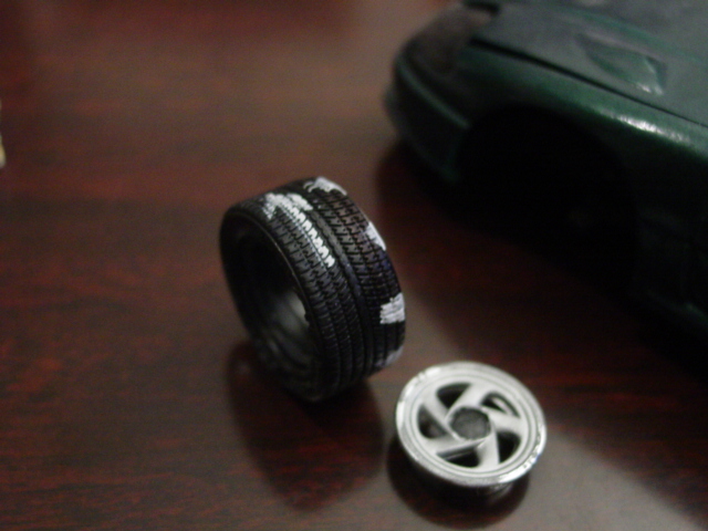

The tire is put back on with the feathered part now on the OUTSIDE. Note as the car sits, if I put THIS wheel/tire combo on the drivers side again, the arrow is going in the WRONG direction.
Attached Thumbnails My Tire Feathering 'fix' from dealer. Please help Me!-tires-004.jpg

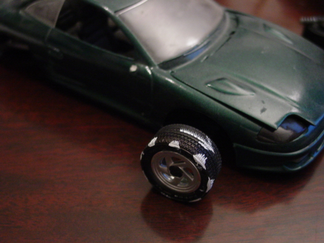

BUT, when I put this wheel/tire combo on the PASSENGER SIDE of the car, it is rotating correctly!
I think you owe your dealer an apology!
