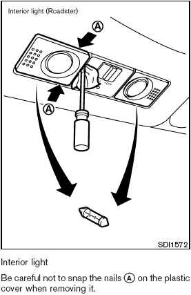

From your owners manual...

so if i bought a new bulb, all i have to do is take off the plastic cover, take off the bulb, and screw in the new one?

Screw in? That one is a snap-in.

no extra stuff or wireing ? in other words, something that can be done by myself in a minute or two very easily?

There is no extra stuff. the old bulb pops out, and the new one pops in... DONE.
A child could do this...

Marchockey, this bulb is available at any auto parts store and is listed as a DE3175. When removing the plastic lens cover, as per the picture so kindly supplied by DavesZ, it will be easer to pry off without damage if you push and hold down the other side of the lens cover. (As in turning on the light).
This is an odd torpedo shaped bulb with the electric contacts on either end, a very old fashioned looking contraption. Just for the hell of it, I checked, and sure enough it’s the same bulb as used in the dome light of grandpa’s old Nash Metropolitan. Quite adequate for a sedate Met driver, but not for a gallant young man-about-town like yourself!
This tubular little bulb measures 1.25 inches (or 31mm) long and luckily, some super bright led replacements are available. Stay away from the ebay cheapies and look of an all-metal-base, unit with a full one watt draw. The light output is three or four times that of grandpa’s bulb and has a perfect spot focus.
