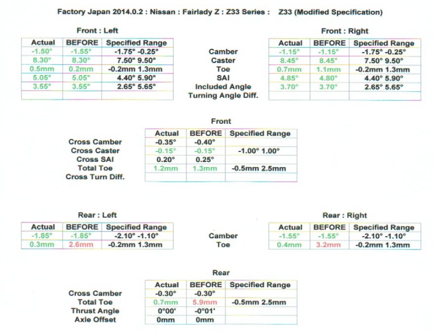

Hey Team,
After obliterating my Lower control arm inner bushing on a pothole, I decided to replace them with the whiteline ones that the folk on here have recommended. The clunk that was present is massively reduced, but there is still a definite clunk coming fron the left side when it is turning right and while braking. Can't feel it while reversing.
Got a shop to install the new bushings since my insurance doesn't cover me replacing things myself unless it's with OEM products. So they installed the Whitelines and did a wheel alignment for me - but i'm still getting an annoying little clunk.
Here's a couple of videos to demonstrate the problem (sorry for vertical video).
One thing I also wanted to confirm was whether the shop did the alignment to the proper specifications. The values I got from the nicoclub website (found on page 21 here http://www.nicoclub.com/FSM/350Z/cou...adster/FSU.pdf) are different from the values that they aligned it to at the shop - see attached photo. But I'm not sure if the new bushings should alter those recommended alignment specs.
As per the video, I think my problem might be the inner or outer tie rod ends, or the strut mount - but thought I'd get some advice before taking it back to the shop. Thanks

Your alignment is fine, a little uneven but fine.
Just need to check your tie rods, ball joints, wheel bearings, loose bolts, etc, its one of those things.

Thanks for the reply. From the sound I was getting in the video I linked, it sounded like tie rod inners were the cause. Just to make sure, I bought myself a torque wrench and will tediously make sure everything is screwed down right before I take it into a shop and pay 4 hours of labour for them to try and diagnose it. Will post back here once it's done.
