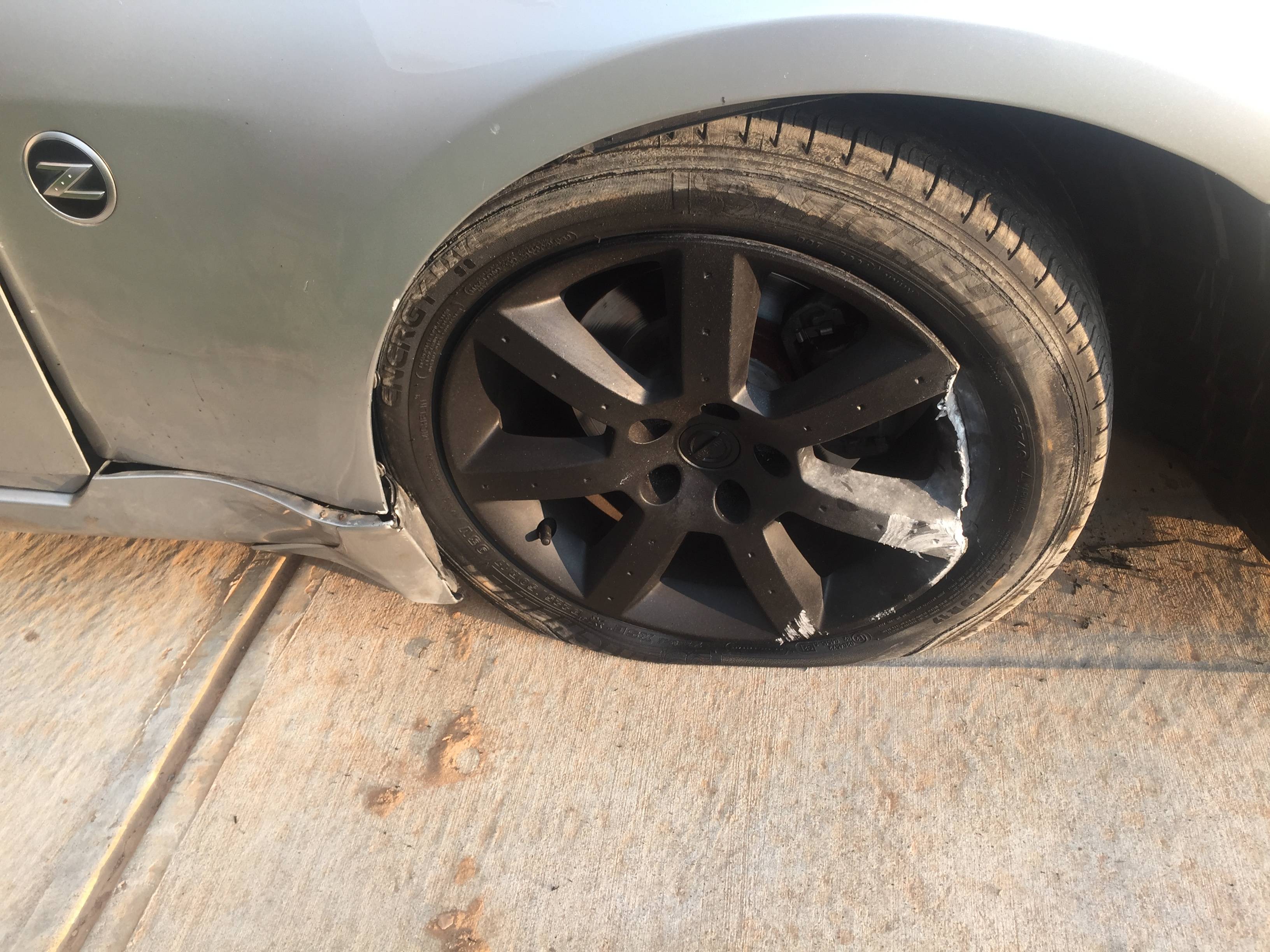

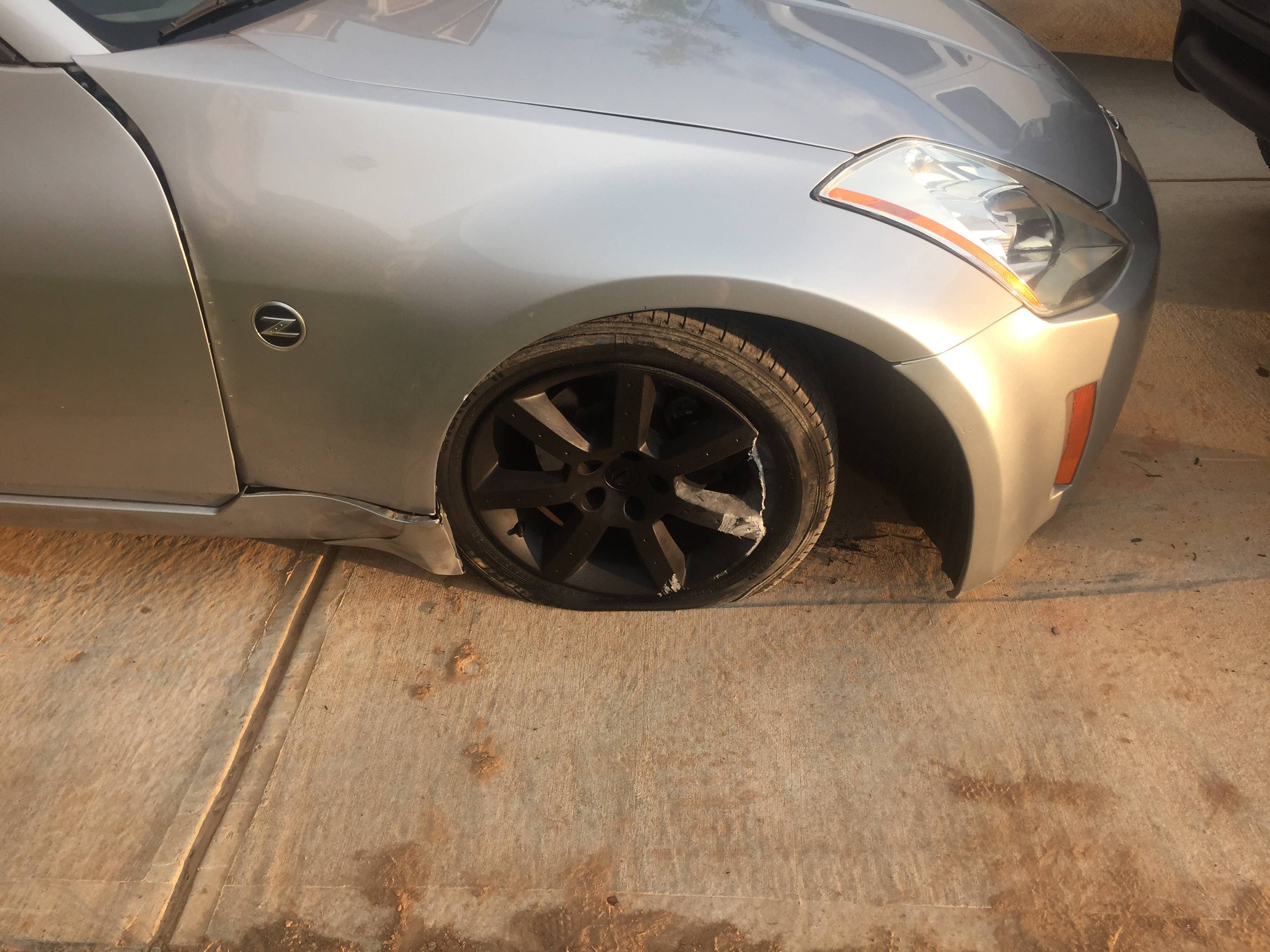

Well, I was going a bit too fast, and hit curb (to cut the story short I was a complete idiot, I deserve whatever is said, lesson learned)
Here is some damage:
https://i.imgur.com/kQ5vIJm.jpg
https://i.imgur.com/HN9YSkc.jpg
The wheel turns and rolls fine.
Anybody have a general idea of what will need to be done mechanically? Frame damage? I'll worry about the looks of it all later.

helluva first post. you will def need some suspension components, we can guess all day long but we can't get under it to look at it. i would claim it on insurance and be done with it

not to mention fender and side skirt work....

if you have full coverage , claim it... even if you have the 1k deductible , it will still be cheaper than you will pay out of pocket

Moving on, wheels for sure, tires, probably control arms. Maybe the wish bone depending how hard you hit. Shocks could be leaking. Sway bar bent maybe?
Overall, this is gonna be expensive.

Fenders mashed, door looks like it could be okay with small massaging on the lip. Like others said, at least......wheel/tire/control arm/trailing arm/ball joint/sway bar end link/sway bar?/tie rod end/tie rod?/knuckle itself(if hit hard enough), easiest thing to do is find someone with a wrecked Z locally or willing to ship parts and make a list of OEM stuff you'll need. Buying everything new would set you back a very pretty penny.

If you didn't hit the fender, but it is pushed back like that.. you may have some frame damage too. Pop the hood and look for some crinkles on that side.

I believe I hit the fender a bit, and side skirt.
Anybody have any ideas on the damage in the album above?

Just quick look on my phone, lower control arm, check other ones inner bushing its prob blown out...might as well replace both, endlinks, shocks, alignment

Got to thinking.. you need to check the steering knuckle as well. Fenders are cheap so i would do that last
