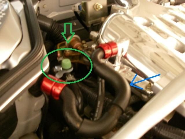

Also, check and make sure the green evap valve cap is tightly screwed on. It's located in the engine bay on the passenger side. You'll see it..

Thank you! I ordered a new gas cap right away. I was trying to avoid it being the filler neck. I will check the evap valve.
