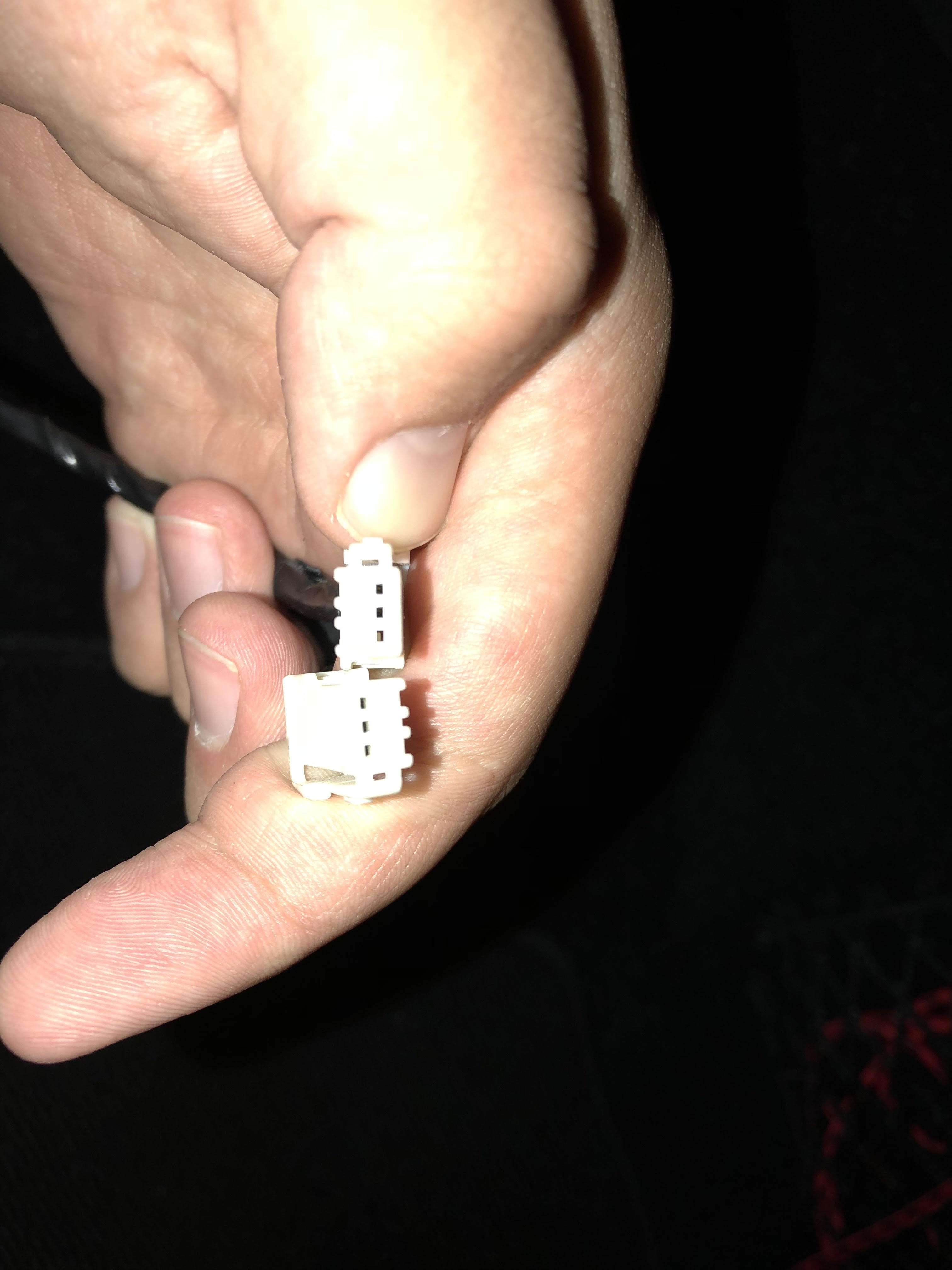

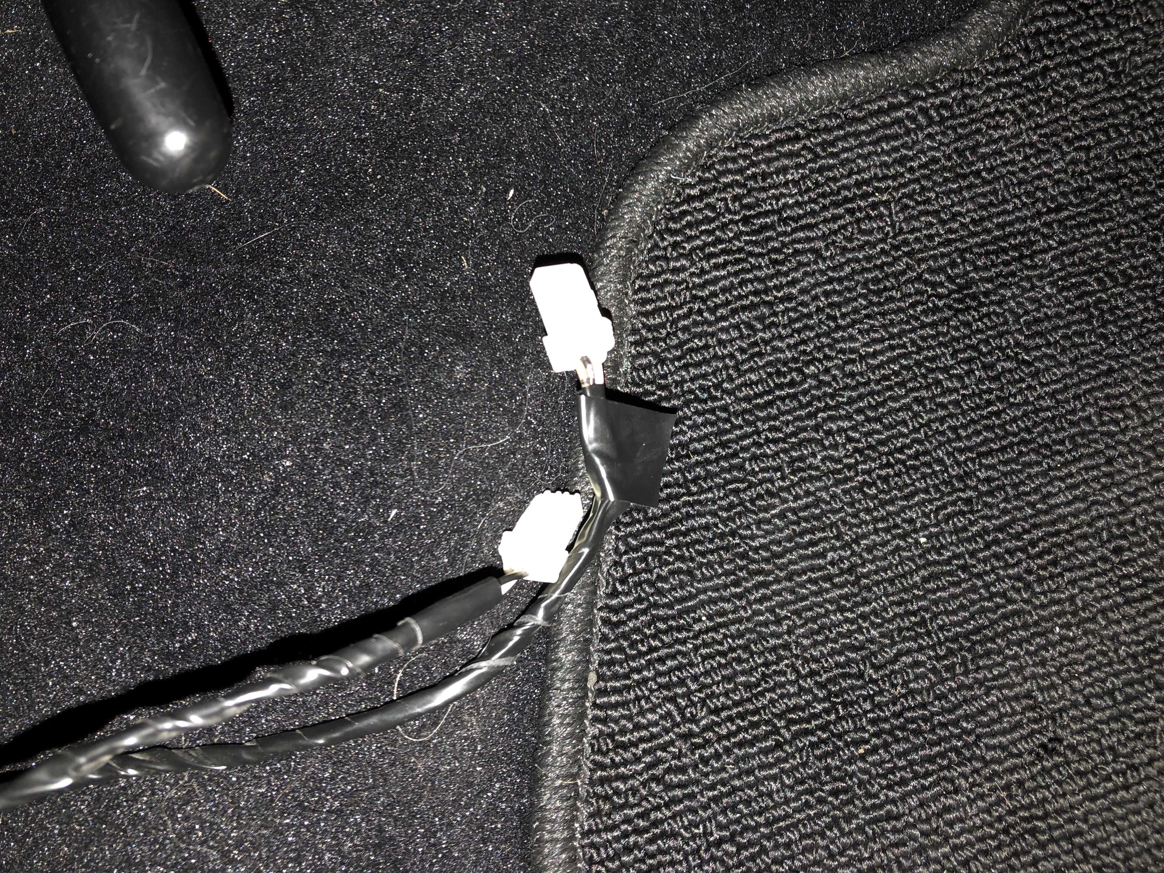

I just recently bought another 350, and it looks like it does not have the plug in for the passenger occupancy sensor. The passenger airbag never turns on, even with a passenger. And of course the airbag light is on. The seats are of course from a different Z. What am I missing? I'm not really interested in putting a new sensor in, I will bypass it. I just dont know where the plug is. Google hasn't helped. I have two plugs, one looks like the plug in for the seatbelt, the other one I have no idea. How do I fix this?
Attached Thumbnails 2008 Passenger Seat Occupancy Sensor-unnamed-1-.jpg   2008 Passenger Seat Occupancy Sensor-unnamed.jpg

Thats not the issue though. There is no plug coming from the car itself to plug into the occupancy sensor, even with the seat out.

The seat belt buckle connector is a white 3-pin connector like the one in your photograph. The occupant classification system connector is a white 8-pin connector (2 rows of 4, only 3 wires) and would be located hear the front edge of the seat bottom if installed.
