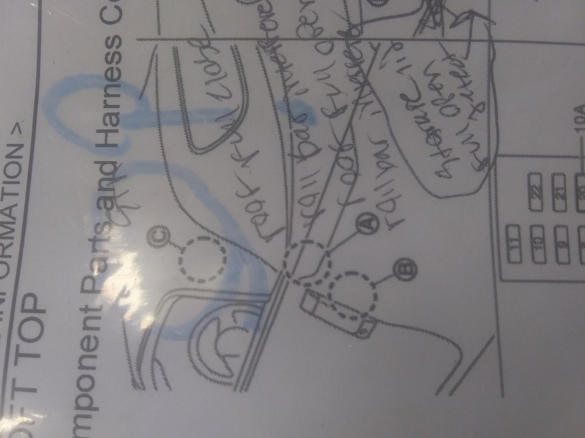

Default this is what I speak of
why does is say replace rr plate rail as assembly what happens if you just replace a single sensor switch this is what broke everything allegedly
