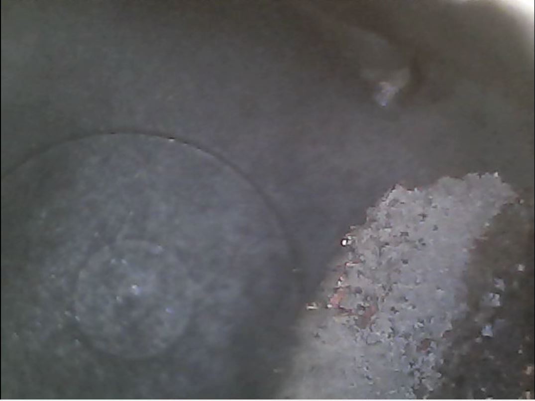

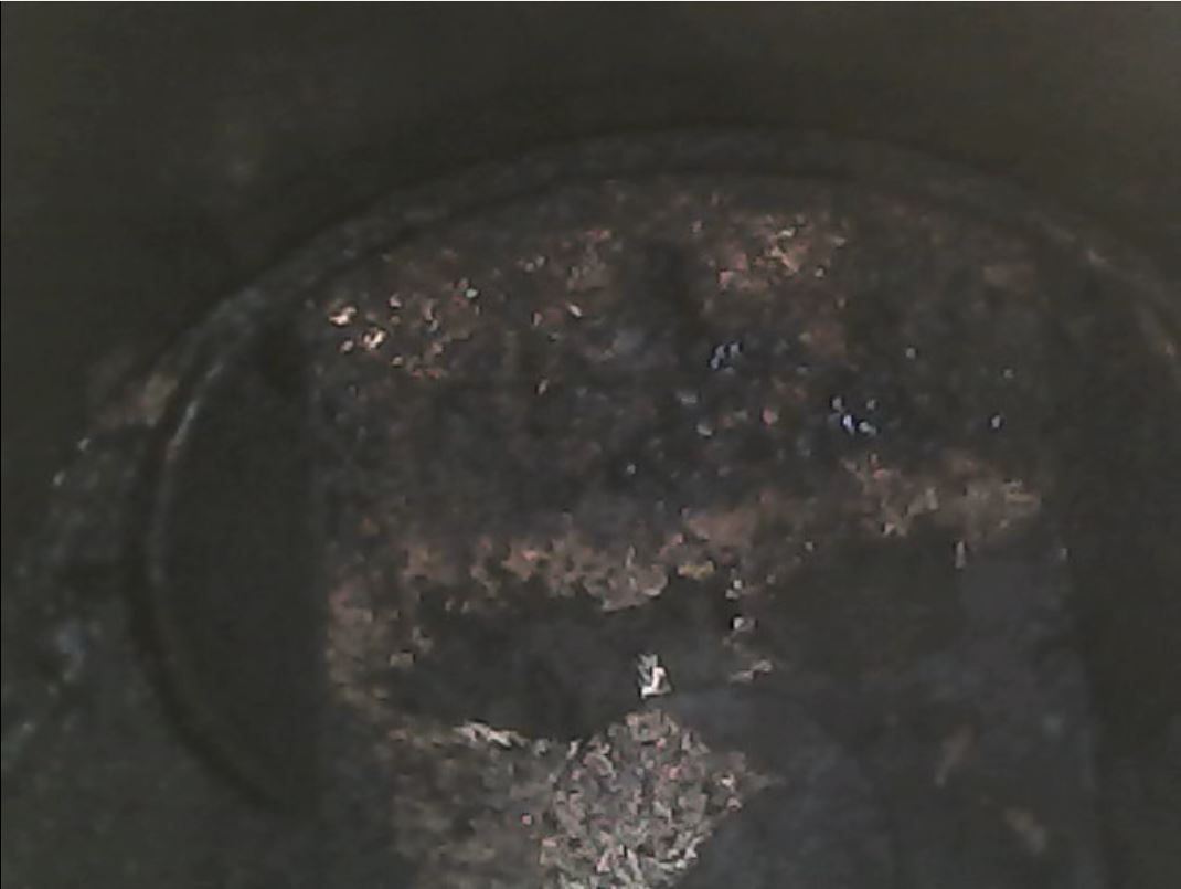

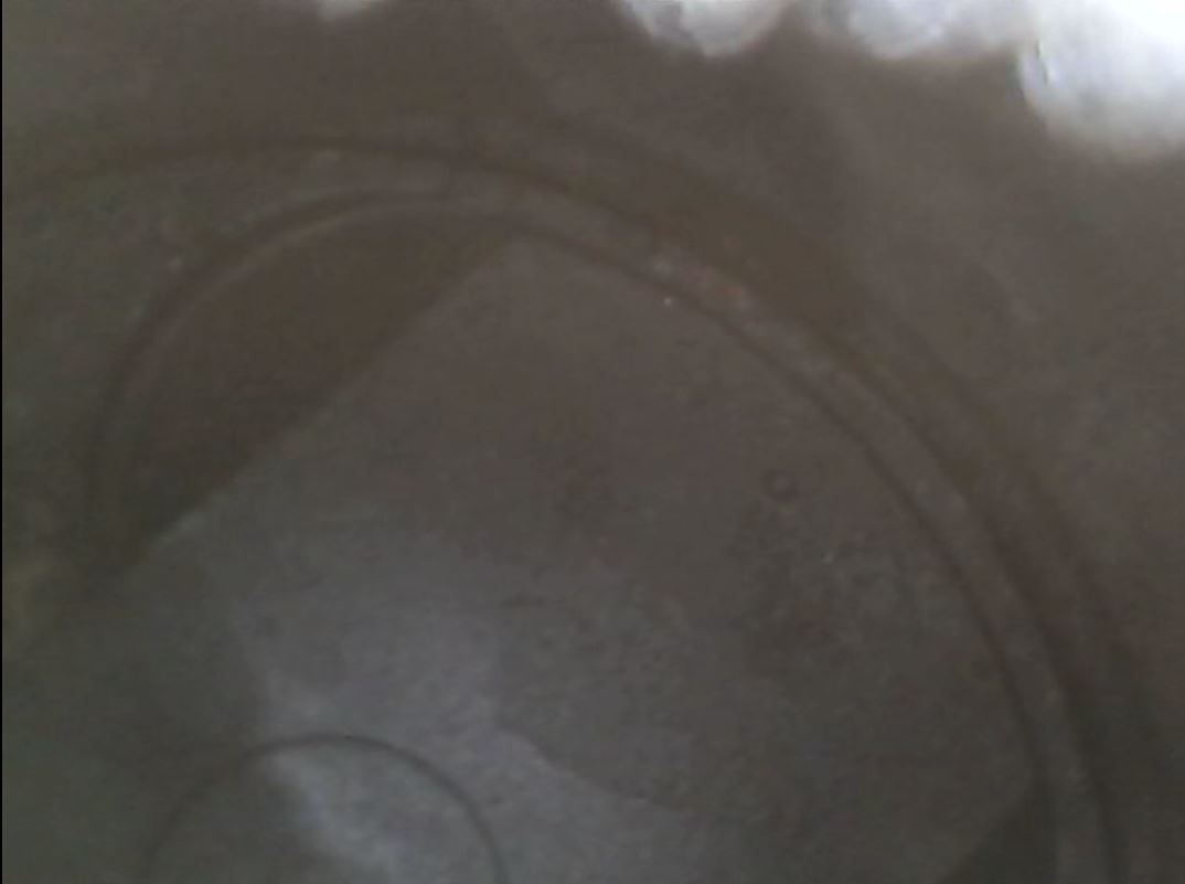

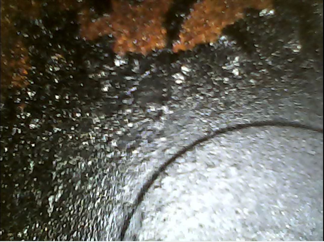

Borescope check of each piston. See pics below. Any idea what the gold colored deposits are?

looks really good
look for rust on the walls but it looks great.

Sounds like you're being very thorough! Maybe a few things to consider IF it doesn't fire up-
Spark plugs- definitely worth pulling 2, if there's evidence of rust I'd go ahead and install new.
