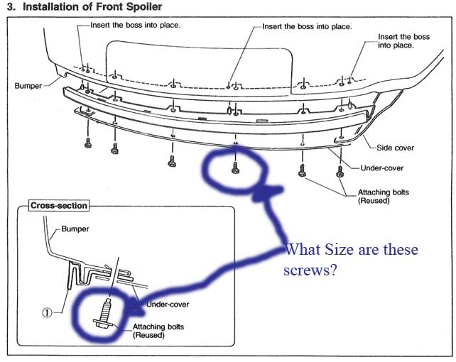

as stated in my previous post. It appears that the dealer darn near stripped my fasteners. I plan on making a trip to home depo to pick up some replacement. Does anyone know what size to get?

I dont know the size, but if you take the screw out of the top headlight mount in the engine compartment, its the same. you can compare it in the store.

6mmx1.0 thread pitch. Use a 10mm socket to remove them
