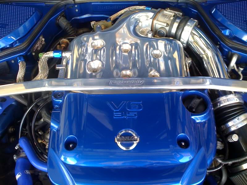

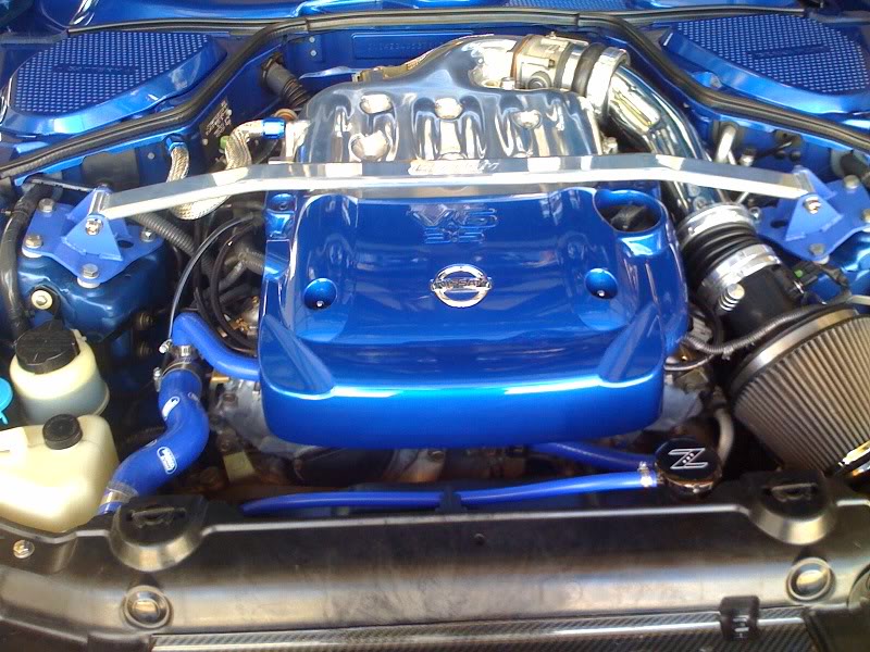

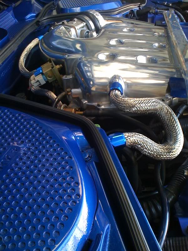

Braided Hoses.

^ wow that looks nice. matches with the blue perfectly.

Thanks...yeah I was really surprised how well it matched. It was a PITA to install though.

The quality on those hoses make me sad

Yeah after my struggle to get them installed they ended up looking like that. That was my first attempt, I'll probably re-do it at some point but for now I'm pretty happy with the result. I'd really like to replace those hoses with actual braided hoses though...does anyone know where I can get replacements?

you'll be hard pressed to get SS hose to make those bends. some folks just unscrew & push the evap stuff further down behind the plenum. as for the brake booster line, u can either tee it off the evap lines or tap a new hole for it in the back of the plenum.

Are those just threaded AN fittings? If so I can probably make you the correct size instead of having to bend it like that. It would be actual steel braided hose rated up to like 10K PSI that we use on our aircraft brakes.

nah, just nipples with clamps.
