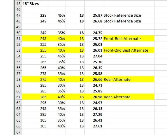

So, I'm out of date I guess. The recommendation now is to run a 245/40-18 on an 8.5 instead of 9 or 9.5 (which is totally acceptable... even OE is 245/45-18 on 8.5)? OK, I get that.
Let me clarify my thoughts (right or wrong): When I worked for Datsun (40 years ago), we had a guy from Goodyear Racing come in and explain how to size a performance/racing tire and he was the first one to introduce me to the "1.2 Rule" (or 120% Rule if you prefer). And that for a racing tire (or performance application), one shouldn't go below 90% tread to wheel width NOR exceed 120%. This doesn't mean a tire smaller than 90% or larger than 120% of the wheel can't be fit to a given wheel size as a lot of passenger and truck tires go well beyond the 120% upper limit. But, performance starts to drop off above and below that due to any assortment of factors, mostly related to sidewall flex/rollover.
So, again, no one is wrong here. But I will go back to the availability issue. 18s seem to be going the way of the dinosaurs for some odd reason. Unless you go with something with a lower aspect ratio, e.g. 285/35-18. But then, the diameter goes all out of whack to stock diameter tires leading to some minor issues like speedo error. But also some semi-major issues like speed sensors going crazy and telling the ECM to "start that VDC thing right now"! Laff...
And just to show you I'm just splitting hairs here, note that I have both 255/40 and 285/40 alternates in my Z tire sizing spreadsheet. I tend to trust empirical data.

Nice chart, not that it's wrong but IMO you should pick your tire sizes and then order wheels to fit. That's how I did it with my Z, I knew I wanted 275/305 and the manufacturer measured width for those is 9.5/11.
After that I figured out offsets, for a 245/275 I'd go 8.5/9.5 or 9/10, no need to pay for extra wheel or have extra weight without use.

I only use the chart to figure out tire diameters for all my cars (but threw in the range of sizes once I got started and couldn't stop). Width is width (with variances between makes and models of course) and yes, measured widths vary quite a bit but as long as we're in the ballpark and it works, no mattuh.

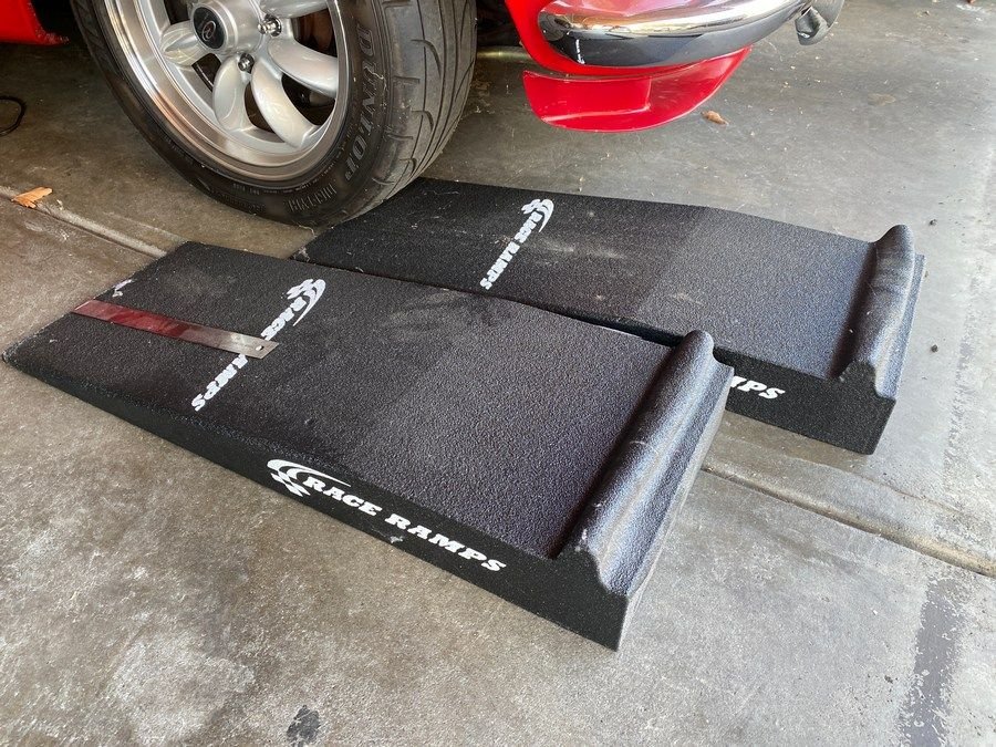

Don't recall model and there's two cars blocking the garage right now. Will look at them tomorrow. But from memory, they are 4" at the highest point, only about 36-48" long and have a wheel stop moulded in at the end but no trough (depression) at the top for long term storage.
EDIT: OK Daniel, decided to go move all the cars and such just for you! (And my I-need-to-know/OCD was bothering me. ) And I think its going to keep bothering me because I do not see these on the Race Ramps site! Near as I can tell, they are most similar to these but shorter.
I was wrong: Note the 12" rule on top. Full length is only 30". So I don't know what model they are. Don't think they're copies, I seem to recall buying them direct. But whatever, they do the job, almost as well as the homemade roll up stands my dad built from yesteryear.

Thanks Mic! Maybe you have a discontinued model, but they look very similar to the 3" Track-Jax Ramps with the stop.
Thanks for playing musical cars!
EDIT: Upon further inspection, I'm about 99% sure you have those with them being 30" in length. Race Ramps FTW!

Yup, that's gotta be them. And yes, they're only 3" tall.
No matter what they are, they work. No more bangin' the jack on the front bumper or on the x-member.
