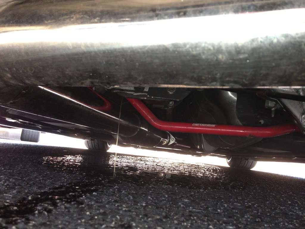

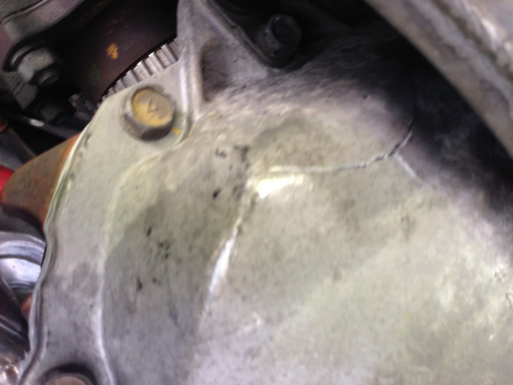

my cars diff finally took a **** on me today
Old Aug 9, 2013 | 08:15 PM
  #288
Bmurray350z's Avatar
Bmurray350z
iTrader: (34)
Joined: May 2011
Posts: 8,075
Likes: 92
From: Burlington, NC
... Cracked diff cover... Can't wait to open it up and see wtf happened
Old Aug 10, 2013 | 12:31 AM
  #289
350Zdj's Avatar
350Zdj
Joined: Aug 2008
Posts: 1,914
From: Dubai
Damn... I'm pretty sure it's because all those hard launches on the slick tires.
Nice vid. Your Z screams like a beast
Old Aug 10, 2013 | 02:38 AM
  #290
0jiggy0's Avatar
0jiggy0
Joined: Aug 2008
Posts: 7,418
Likes: 13
From: Long Island, NY
WOW, prepare for mayhem
Old Aug 10, 2013 | 03:00 AM
  #291
Bmurray350z
iTrader: (34)
Joined: May 2011
Posts: 8,075
Likes: 92
Thanks Dj.. had the gears been properly set this probably would have never happened

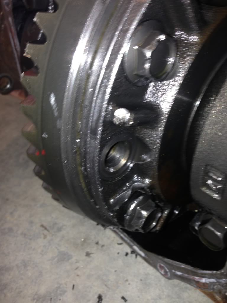

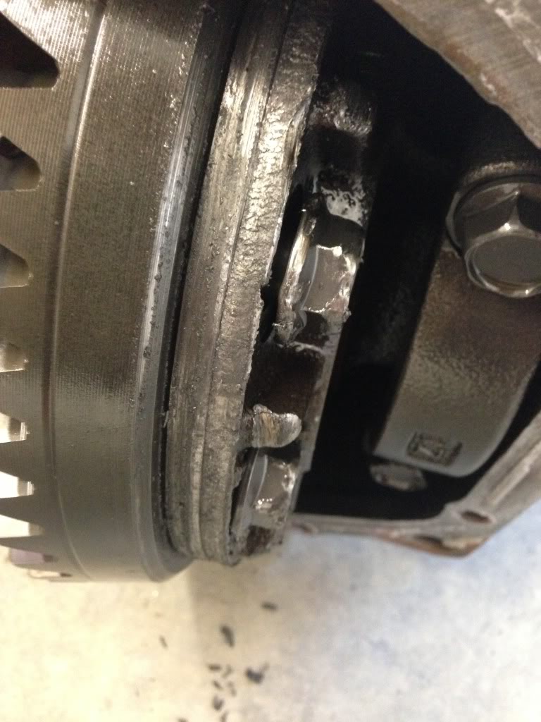

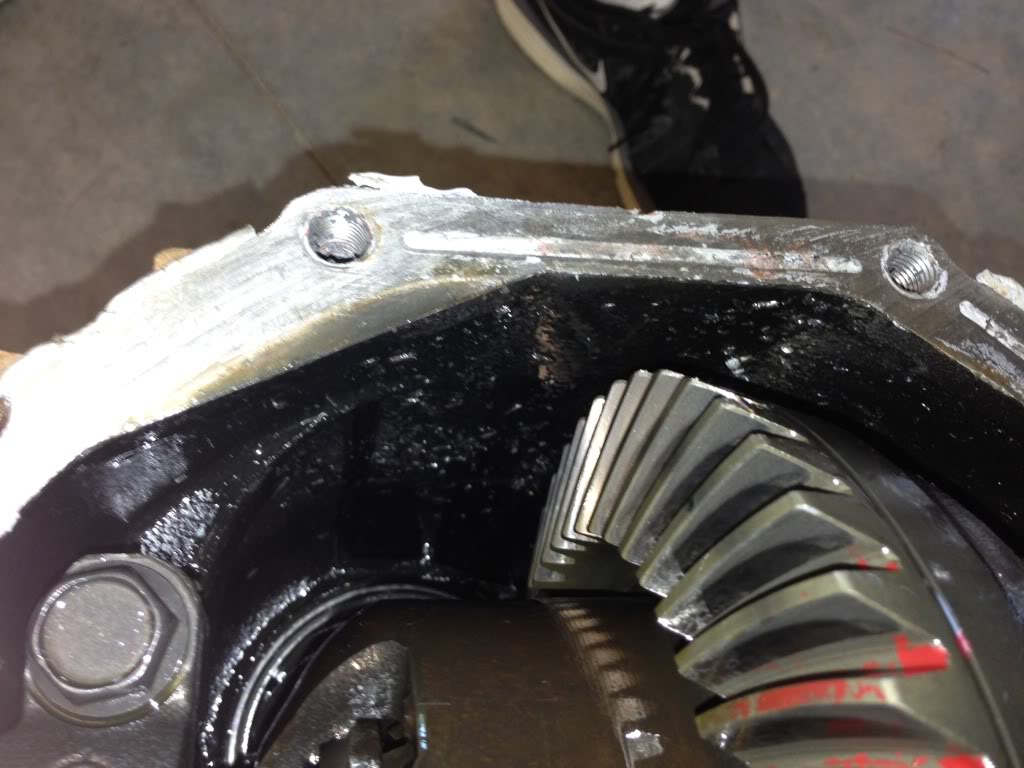

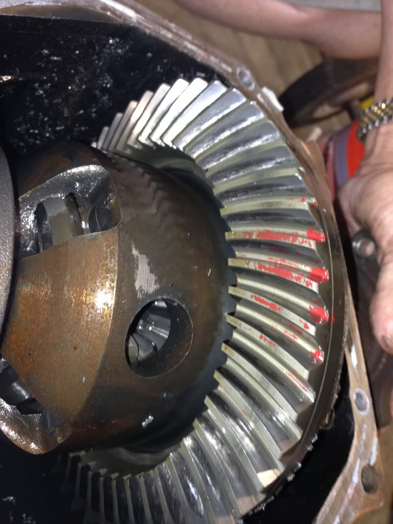

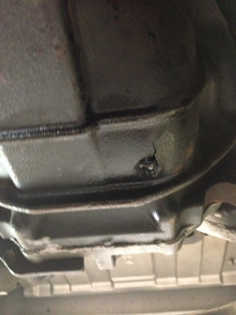

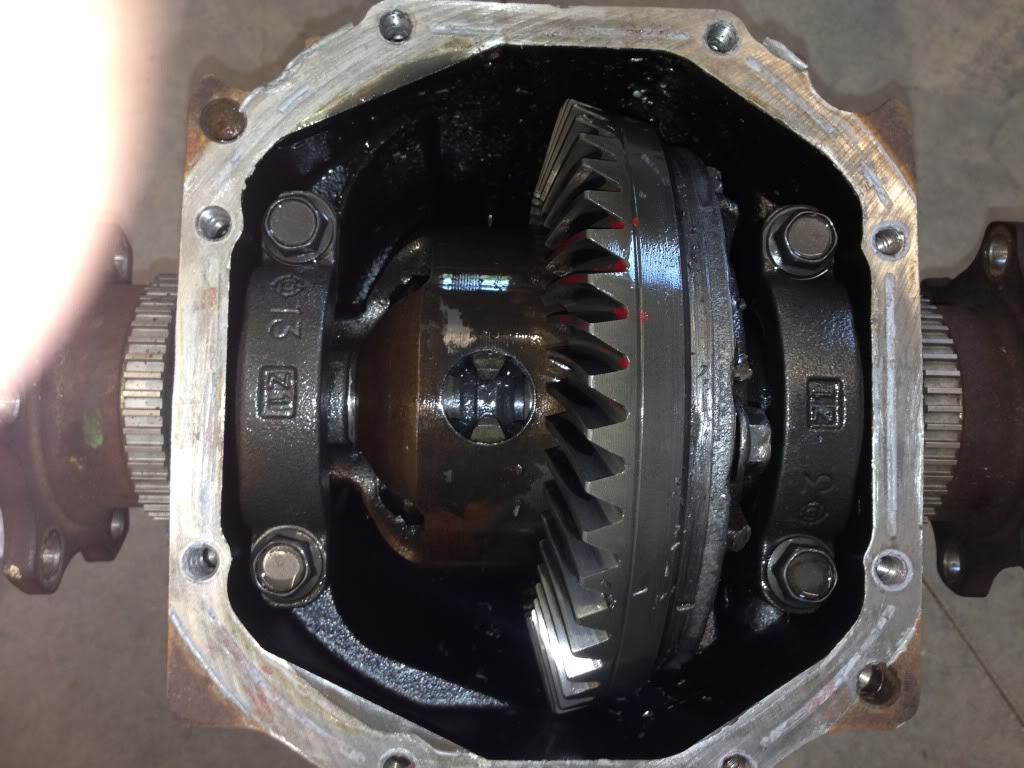

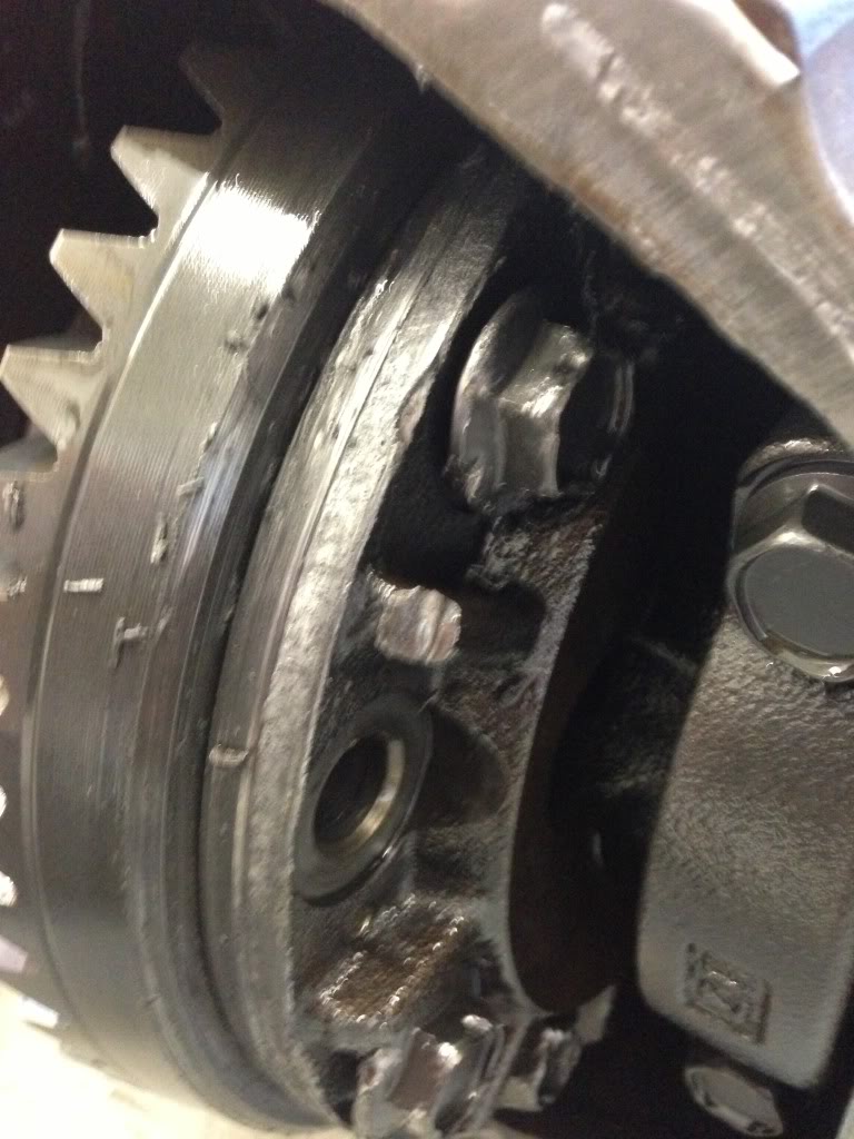

Got the rear end out and opened her up... here's what i see
the pumpkin is cracked on the bottom:
Missing 2 bolts out of the (ring gear?):
Basically all of the bolts are loose:
Found 1 bolt just laying in the pumpkin, other one probably just got ate up i guess? see all the metal shavings on the inside:
So here is my guess.. the bolts came out, got lodged between the ring gear and the inside of the pumpkin and when it spun, it just cracked the pumpkin/diff cover?
Old Aug 12, 2013 | 08:22 AM
  #293
sry110's Avatar
sry110
Posts: 6,650
Likes: 36
From: Malvern, PA
Wow. Who built the differential in the first place? Was it a custom job by a shop, and if so do you have a case for having them fix/replace it?
Old Aug 12, 2013 | 08:28 AM
  #294
Bmurray350z
iTrader: (34)
Joined: May 2011
Posts: 8,075
Likes: 92
No about 4 months ago i found the whole unit on craigslist for a crazy good deal. drove 4 1/2 hours to go pick it up.
the diff and gears were already installed inside the pumpkin so all i had to do was swap the pumpkins. so never would have known anything was fcked up inside..
probably would have been smart on my end to have it checked over, but labor for setting these gears are pretty pricey and i figured it will hopefully be done right... i was wrong.
Old Aug 12, 2013 | 09:42 AM
  #295
Voboy's Avatar
Voboy
iTrader: (58)
Posts: 2,995
From: Houston, TX
^- did you buy the gears from the other guy? those gears still look good to me...
Old Aug 12, 2013 | 10:17 AM
  #296
Bmurray350z
iTrader: (34)
Joined: May 2011
Posts: 8,075
Likes: 92
Yeah gears definitely look salvageable

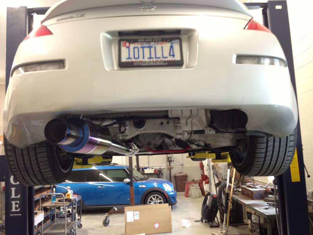

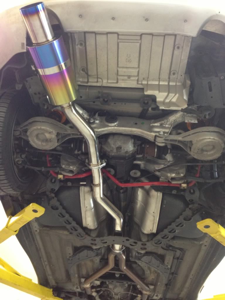

So ditched the Topspeed exhaust, and switched to a Single Agency Power. This thing sounds insane. and is super sexy...
sound clips coming soon
also took the stillen rear off, going to sell it and either get nismo rear spats again or possibly chargespeed rear add ons.
