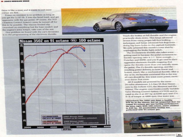

sportcompact car got 5 hp and 2 lb.ft out of 100

sportcompact was the reason i use 100 octane, maybe i should beleave ever thing i read. But then again i got the best run with that setup up. But if it not good for the car then I shouldn't put 100 octane. Maybe I'll try 93 instead.

it's not that it's not good for the car octane is just a fuels resistance to detonate from compression...what some are trying to say is that you could lose performance if you were to use it..like if you were to use 85 octane...i believe there may be some advantage to the higher octane gas in these high performance high compression engines.

looking at the dyno for the Z above notice how quickly HP climbs...so...you start out at an idle or lets say a 2500 rpm launch how many feet have gone by with good traction before you get to 6K rpms? near peak HP...now same run instead you spin at launch far fewer feet of the track have been used before the car reaches 6K this is bad for ET but when you finally hook you are in a more powerful part of your rev range and therefore you'll make more MPH...the AWD WRX thing is just another example of getting out of the hole good they dont spin much at all...can pull a 1.6 60'ft and do the 1/4 in 13.6 @ 100 a very low mph...from a roll theyre not that fast but they can put 2-4 cars on you out of the box...this is where there et is made
ok...your theory can make sense on paper (or on screen ), but I just don't see it happening in the real world.
EXAMPLE From the real world:
My maxima had a very similar power band to the Z (less hp and tq of course), and on my best run, with a 2.14 60' I didn't get one bit of wheelspin at all. I came off the line at about 2500 doing a REALLY quick slip of the clutch (almost a drop). I ended up running my best trap speed of the day hooking straight off the line instead of spinning.
Explain that....
BTW - every other run I trapped almost the same (high 96s), with 60's ranging from 2.2-2.4 and lots of wheel spin and hop...to just a little. Actually looking at my timeslips now, I only trapped 95.89mph on my crazy wheelspin 2.4 60' (first run of the day), and on two other runs I trapped an identical 96.85mph with much different 60ft times.
