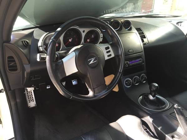

A week ago I purchased a 350z white with black leather (all stock nobody has been ricing it out) in mint condition never wrecked never flooded for $3000, Im in the houston area and found the car in austin texas... so my son and I drove to austin and tow dolly it back. The car is amazing it looks great but one problem crank no start. I have a friend that has a tester he said it cost 10grand that can read the entire car system in this car.. He checked the fuel pump camshaft sensor basically coilpacs all the sensors in the car from the obd 2 port. He said the ecm is not giving him any codes but from the sub menu of his tester he is getting a U1000 communication failure from the IPDM... I have read thanks to another member the factory service manual for this. This dam car is complicated with all the systems talking to each other. Well this is my short introduction... My friend is going to come pick it up and take it to his shop and test all the grounds put it on a lift remove the interior and check all the grounds. From what I can tell there was a nissan bulletin in regards to grounds loosing the impediance and the IPDM losing communication. I think this car could be a problem child, and why I got it for 3k we will soon see. I will update as I get more information.. This is not a hit and run post as I will update what is changed and what he finds. The first thing the previous owner burned up the started and killed the battery cranking on it gave up and sold me the car. Wish me luck. And thanks 350z for all the great information in this forum.

Well, for $3000, let's hope you didn't buy into a money pit. Cosmetically, the car looks very nice. The IPDM isn't that difficult to swap out, and assuming the car is truly NOT flood damaged and your friend with the shop is reasonably competent, you should be okay. If all else fails, take some of that cash you saved and take the car to a dealer and have them hook it up to their CONSULT II system (which costs significantly more than $10K) to see if they can get a better handle on what's going on with factory-dedicated testing equipment.
