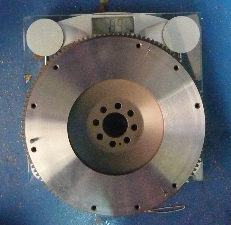

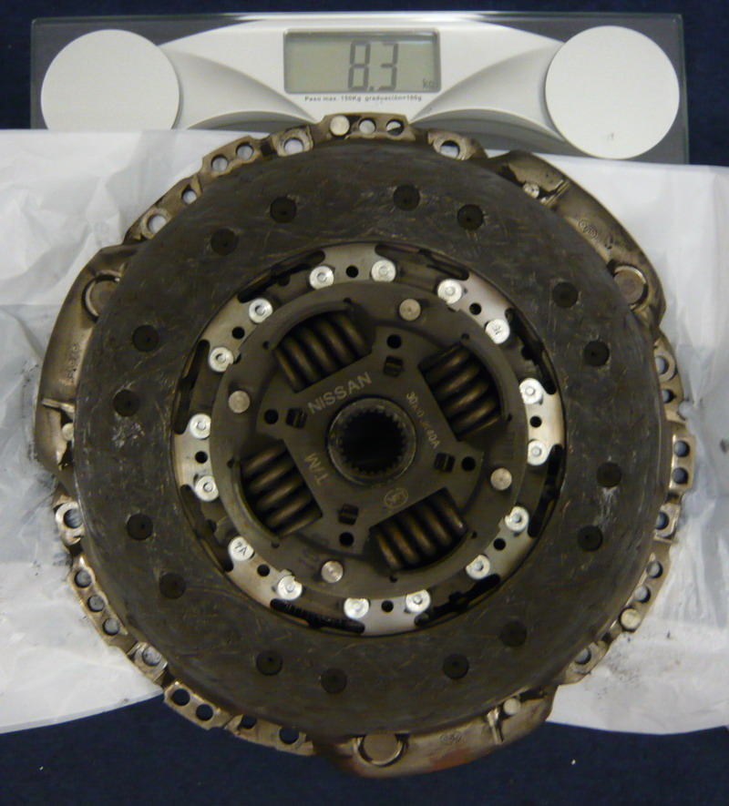

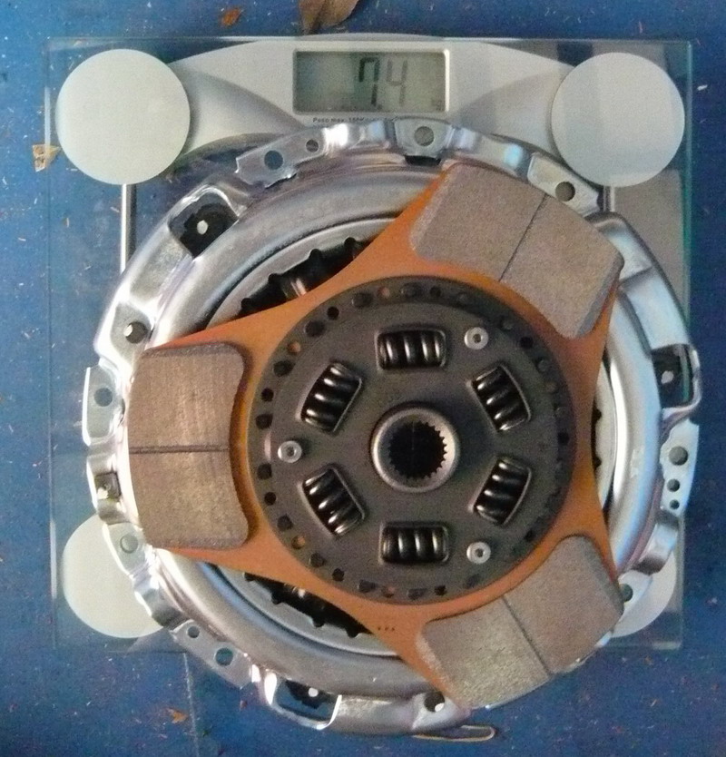

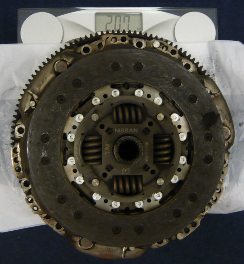

I bought the EXEDY Stage 2 CLUTCH KIT + the EXEDY Lightweight Racing Flywheel from SOLO-350z recently. Thanks RUSSELL!!!
The total weight reduced approximately by 4.5kg(10lbs)
OE CLUTCH = 1.8kg = 3.96lbs (USED, after about 8k+ miles of DRAG RACING and 1/8miles. I don't think there will be much diff. between the new clutch vs. my current one)
OE PRESSURE PLATE = 6.5kg = 14.30lbs
OE FLYWHEEL = 12.5kg = 27.50lbs
EXEDY STAGE 2 Cerametallic CLUTCH = 1.6kg = 3.52lbs
EXEDY STAGE 2 Pressure Plate = 5.8kg = 12.76lbs
EXEDY STAGE 2 Lightweight Racing FLYWHEEL = 8.9kg = 19.8lbs
OVERALL (approximately)
OE 20.7kg(45.5lbs) vs. EXEDY 16.2kg(35.6lbs)
OE FLYWHEEL

OE Pressure Plate

OE CLUTCH KIT
EXEDY STAGE 2 Cerametallic CLUTCH KIT
OE CLUTCH KIT + FLYWHEEL

I already installed the clutch kit & flywheel and have about 300+ miles on them. According to the EXEDY Fitting Instructions it reads: Road test vehicle and never abuse a newly fitted clutch. Allow 750 mi break in and always adjust free travel on your new clutch at 750 mi and 1500 miles. Thereafter, adjust at every 10,000 miles
I don't understand how can I adjust at every 10k miles? Can someone guide me here?
After the first 300+ miles, I don't feel that it is stiffer than the first day I got my NISMO. 2nd, it is harder to shift into the 1st~3rd gears, normal for 4th gear and much more easier to get into the 5th & 6th gear. On the OE, while over 120mph, it was very hard, sometimes impossible to shift into the 6th. But now..... I feel that it is very easy and feels like kind of my gear can just SLIP IN into the 6th gear.
First time when I drove back home, if I don't step on the GAS a bit harder, it feels like the car will STALL. On the other hand, it also feels like it really wants to GO GO GO and GOOOO... I can definitely feel the TORQUE.

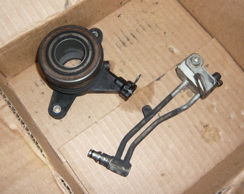

Anyways, I am very happy with this replacement and upgrade. I also ordered 3 autoparts from Dave @ SOUTH POINT NISSAN in AUSTIN, TX. I got the release bearing and these 2 items I don't know what you guys call it.
