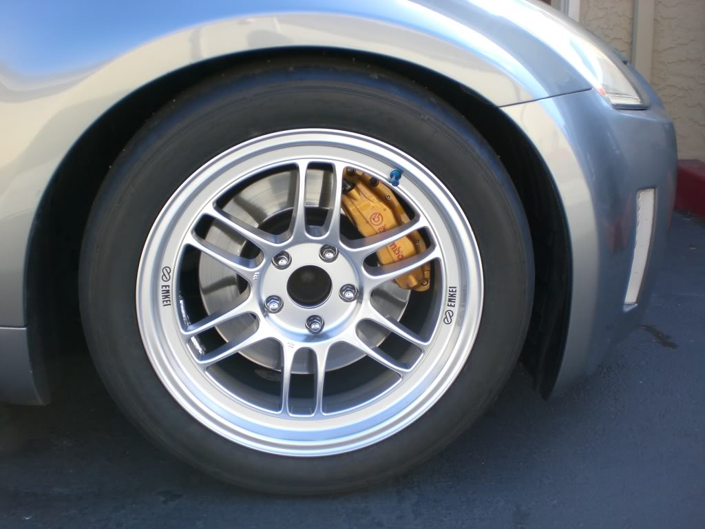

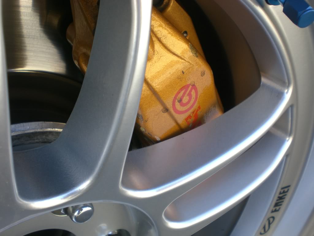

I learned about the RPF1 17x9.5s the hard way, so they do not work without a 10mm front spacer, and then a 275 tire was too big. The barrel of the wheel hits the Brembos - I had those for autox and had to sell them (and I used the SSR Comps instead). The guys that run in the T2 class run 18x9 +35 fronts and 18x10 +38 rears. These types of offsets, of course, are common for our tracking purposes when you want to end up running big tires.
