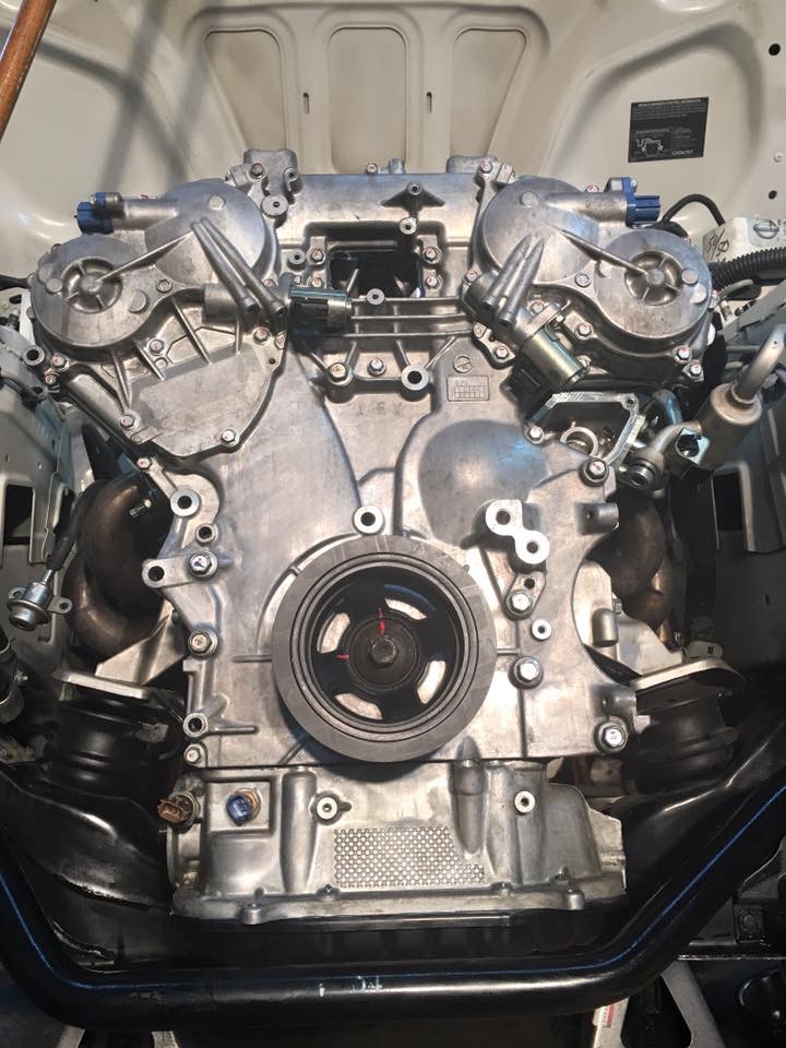

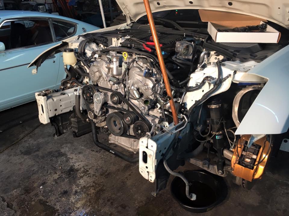

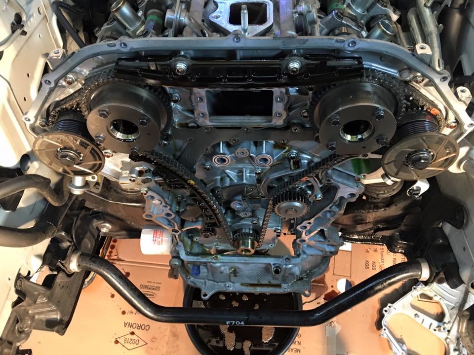

Got to cali to drop the car off to Nick at 5523 motorsports...awesome guys and extremely knowledgable on VQ's. Jwt sent me to this guys. im very glad i did, and will be doing my long block build hopefully with in the year for boost.... Nick started right away. These are photos he sent and posted for me. its also on Facebook for 5523 motorsports. he did a step by step if anyone is intrested in it on how they work....

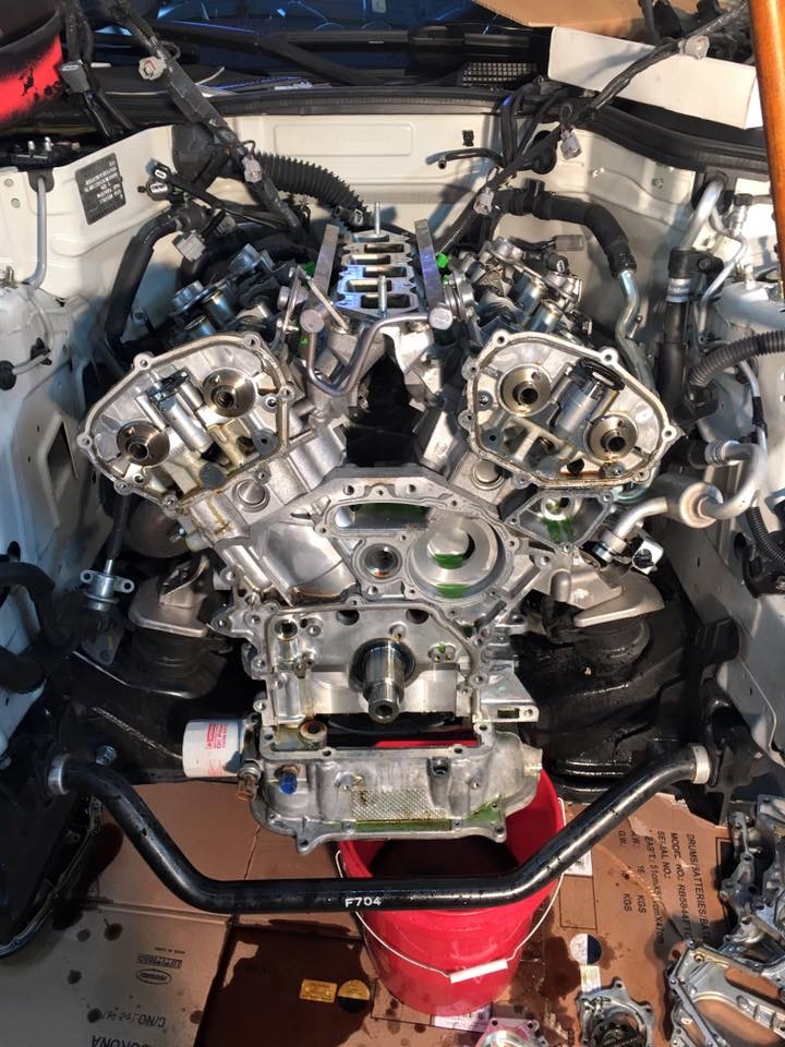

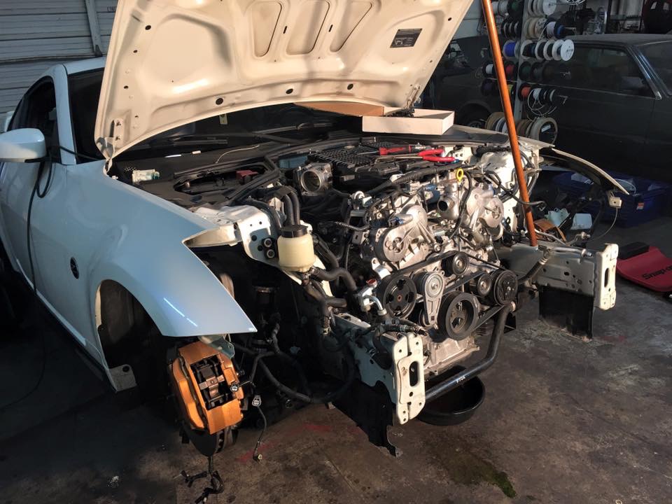

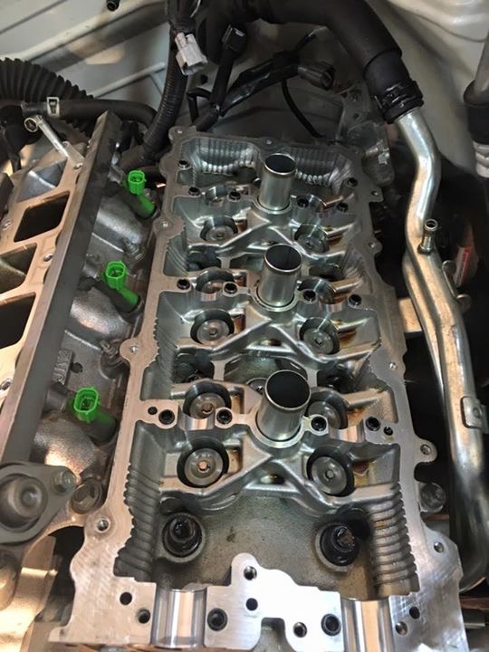

he got it all torn about and started on lashing and speced everything out from the beginning....
Attached Thumbnails #0323 az-img_9954.jpg   #0323 az-img_9950.jpg   #0323 az-img_9944.jpg

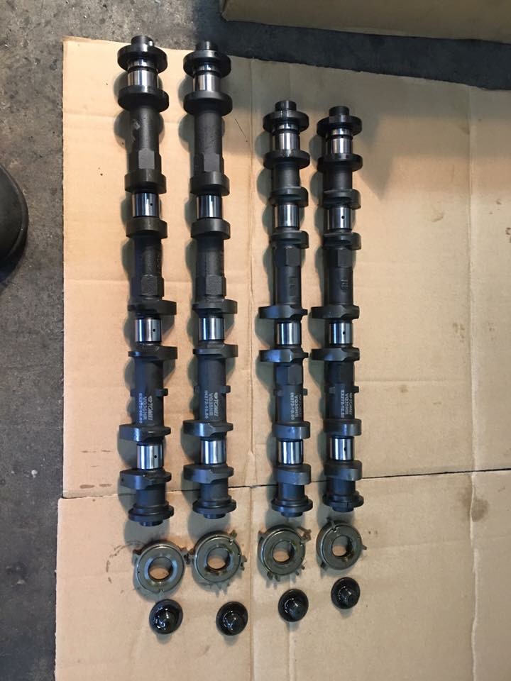

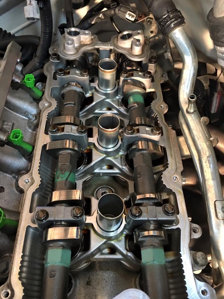

inside of the stock cams..... 248 duration with 10.5 lift....

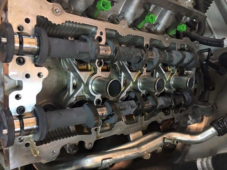

after everything was lashed and re-speced inside and out and degreeing the new tomei cams... Nick put her all back together. He also did all new gaskets and ill try and find more photos.
Attached Thumbnails #0323 az-img_9980.jpg   #0323 az-img_9981.jpg   #0323 az-img_9967.jpg   #0323 az-img_9987.jpg

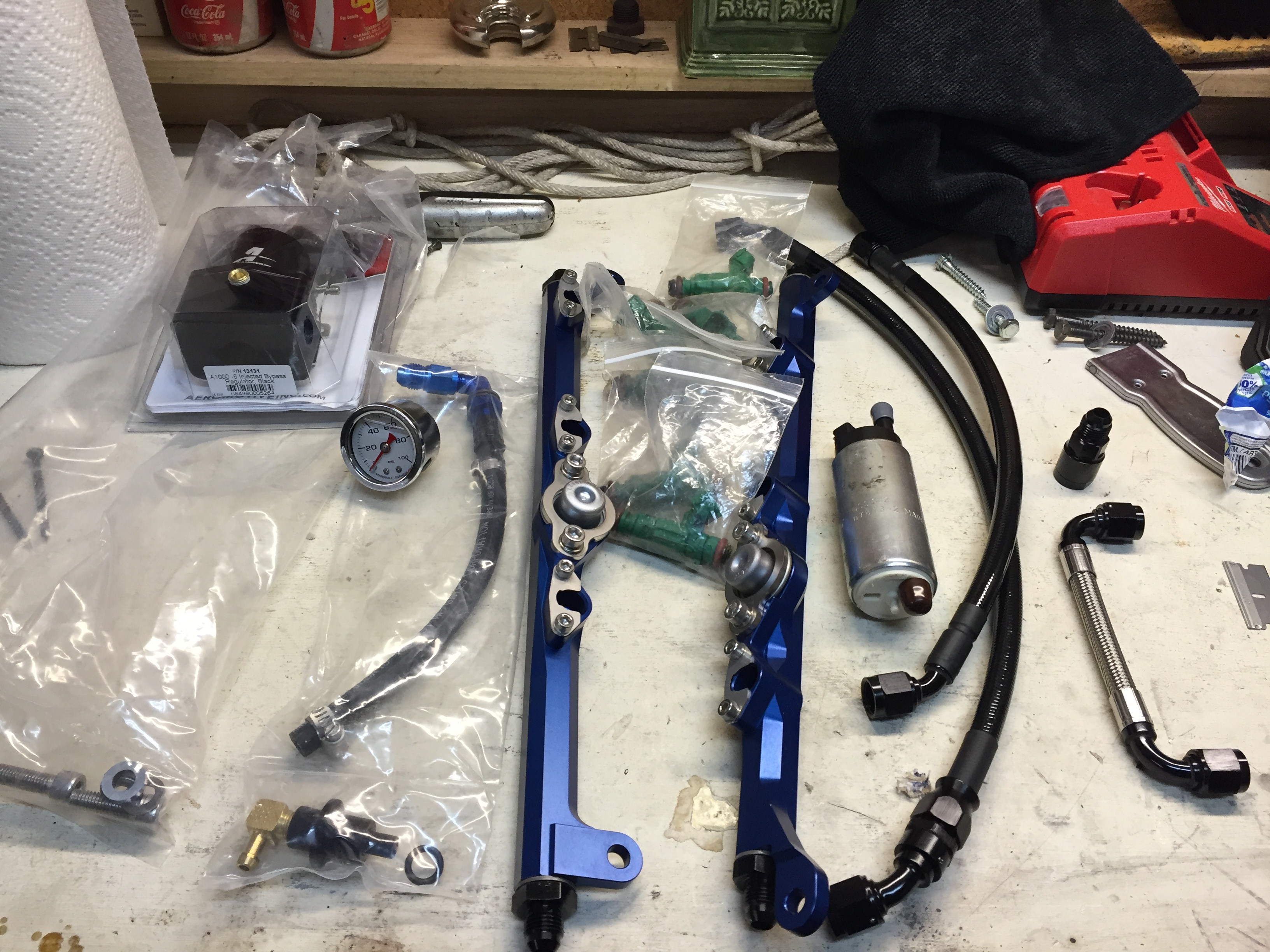

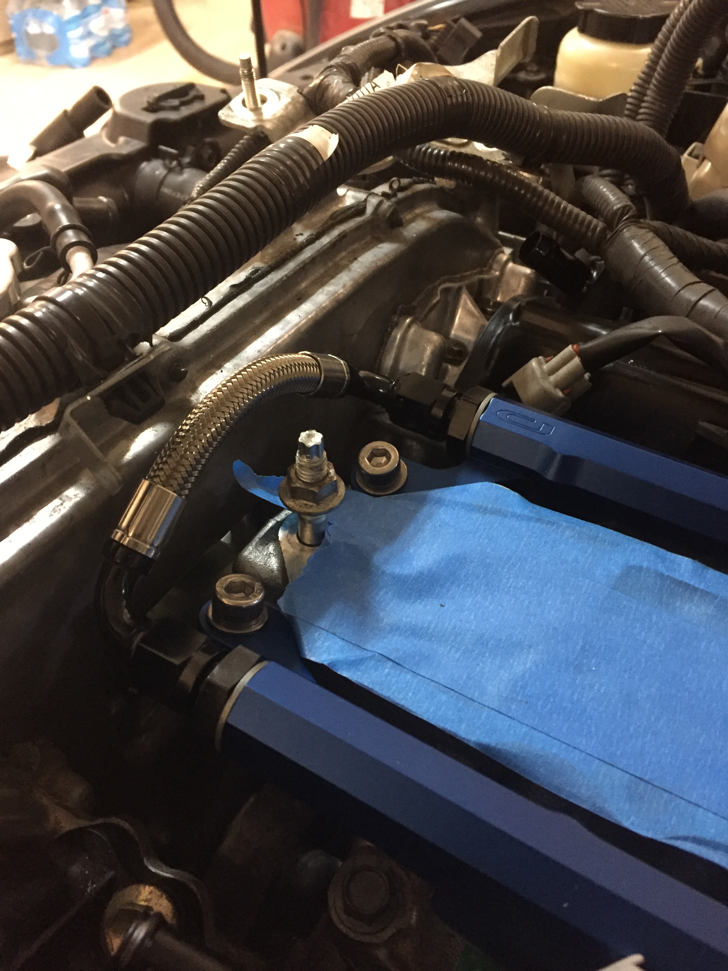

i did the fuel system install myself.... charles made it very easy to install from the instructions on his site. it was spot on!
Attached Thumbnails #0323 az-img_0047.jpg   #0323 az-img_0050.jpg   #0323 az-img_0052.jpg   #0323 az-img_0054.jpg

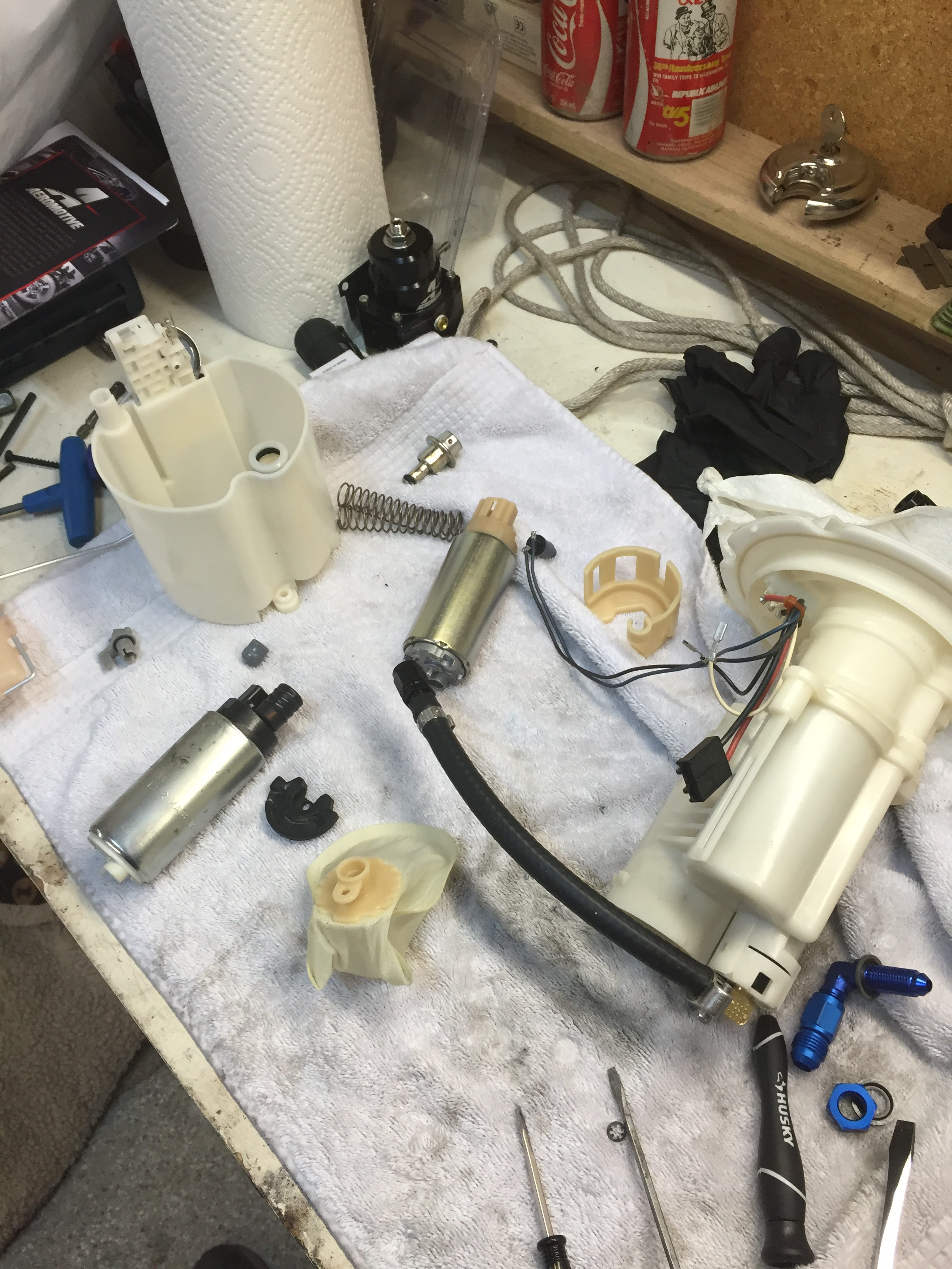

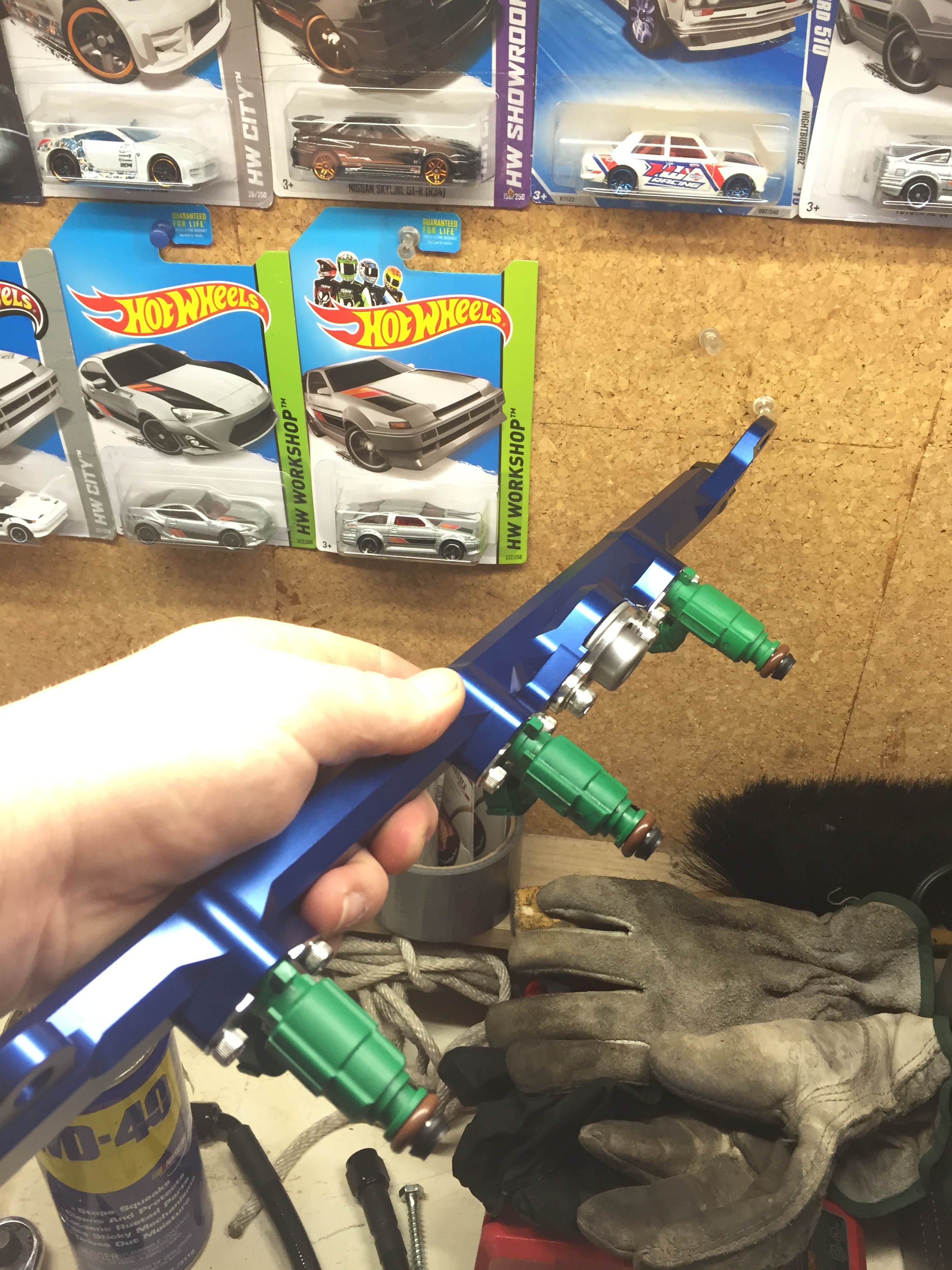

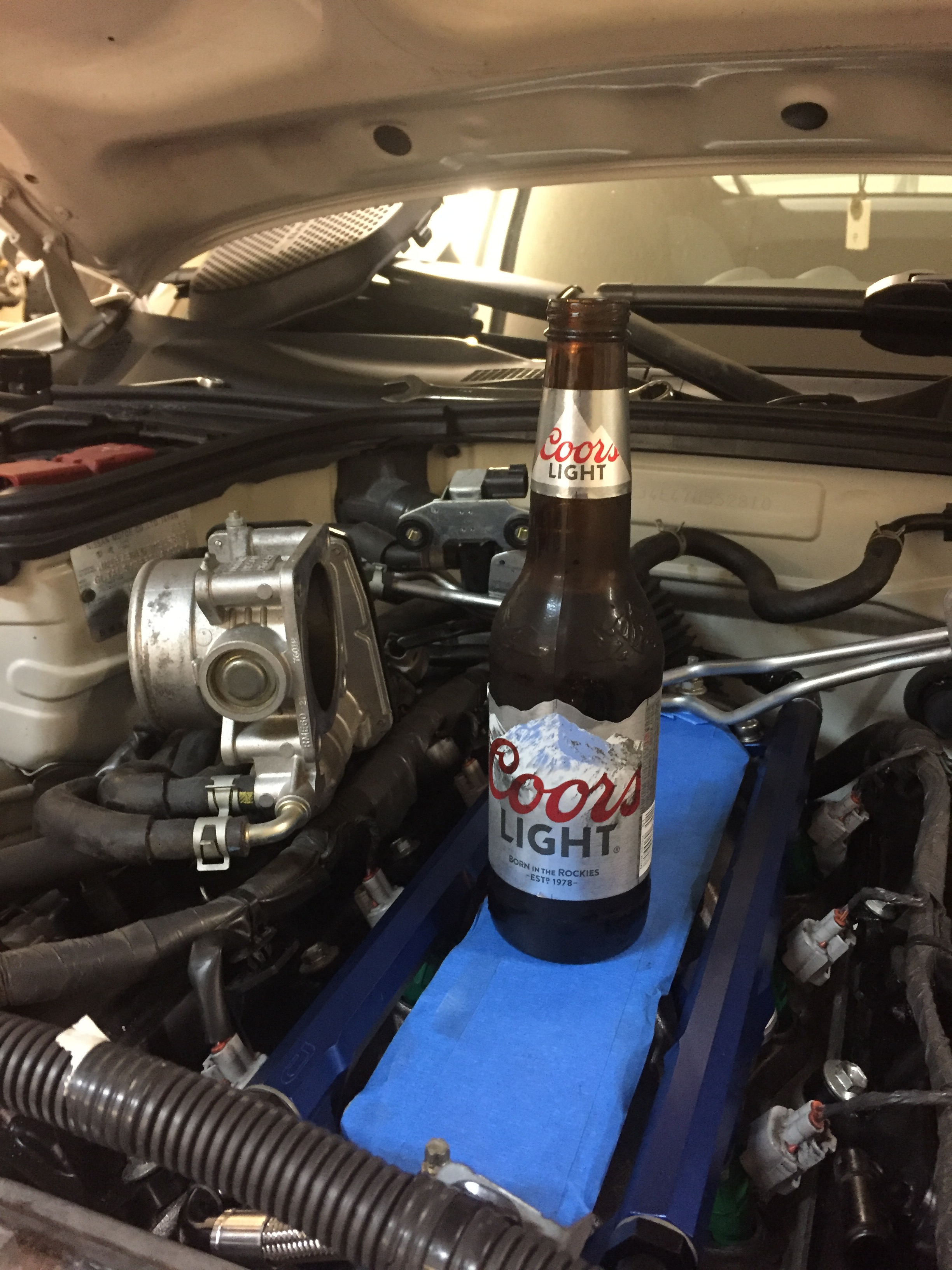

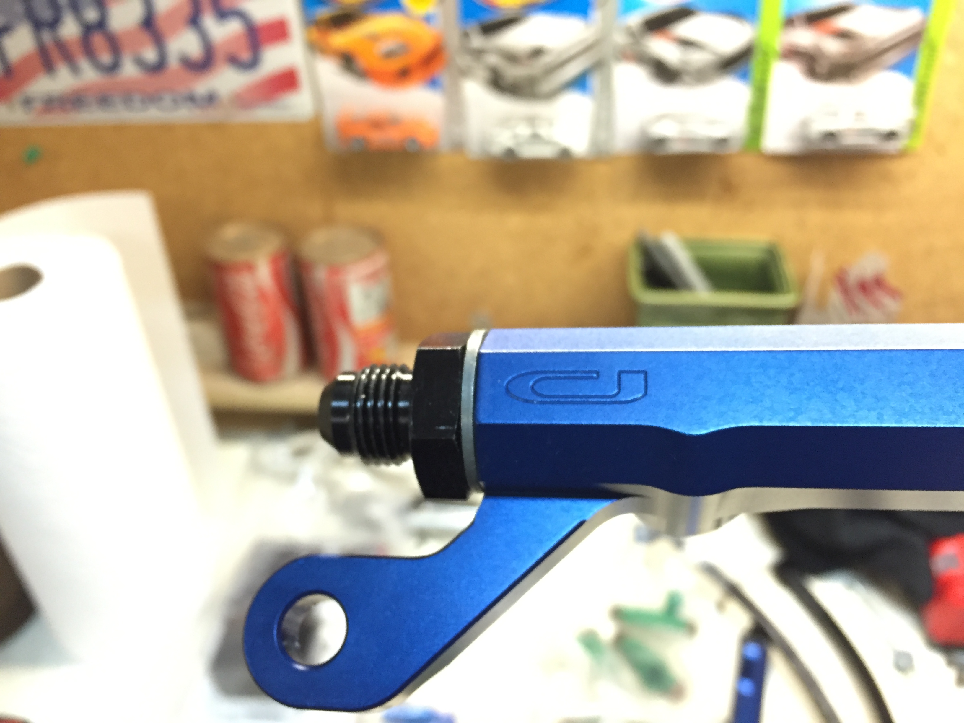

new rails in and some of the AN fittings installed.... and i started on the fuel pump basket and stock regulator bypass for the return...
Attached Thumbnails #0323 az-img_0055.jpg   #0323 az-img_0056.jpg   #0323 az-img_0063.jpg   #0323 az-img_0064.jpg

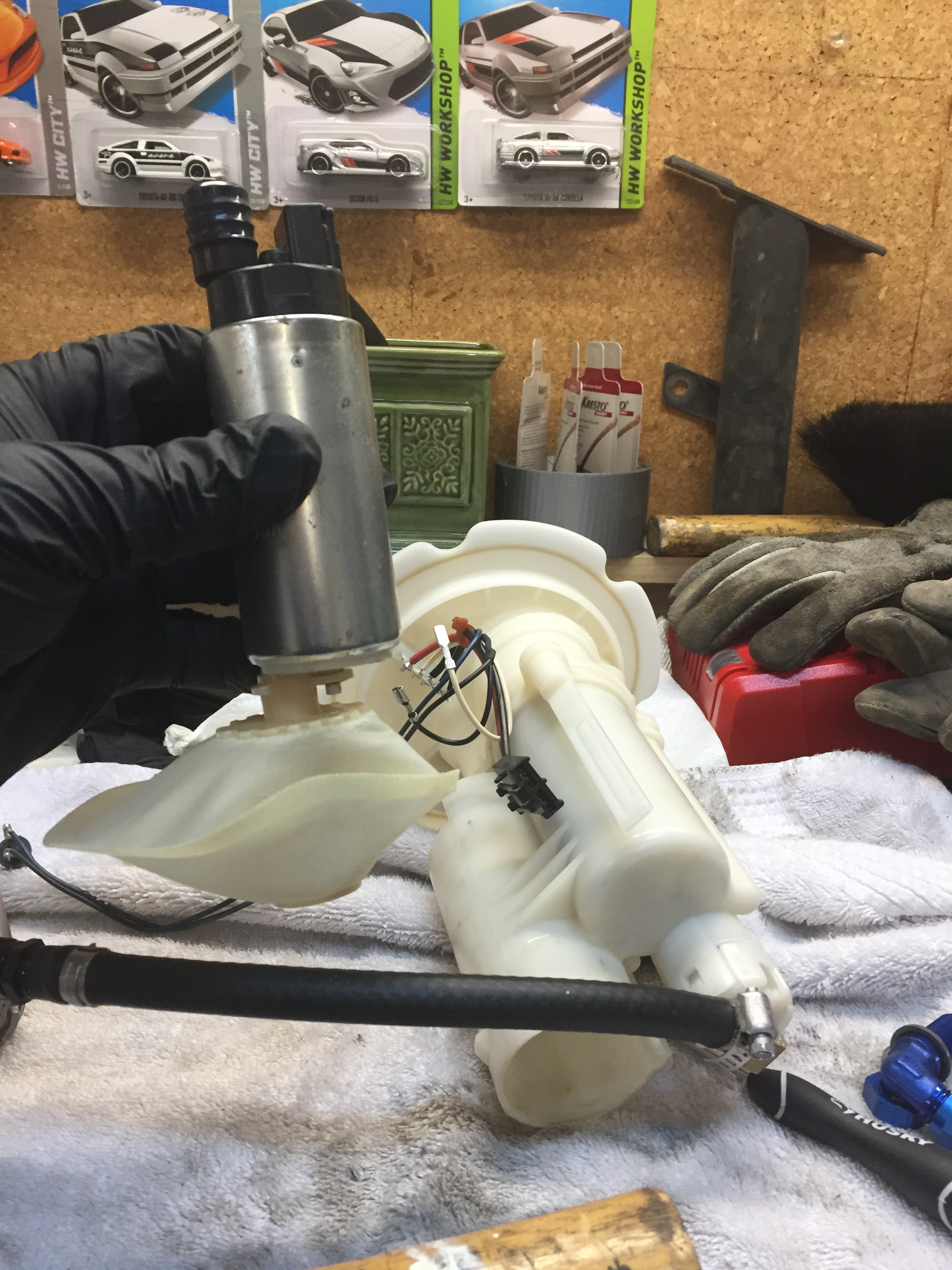

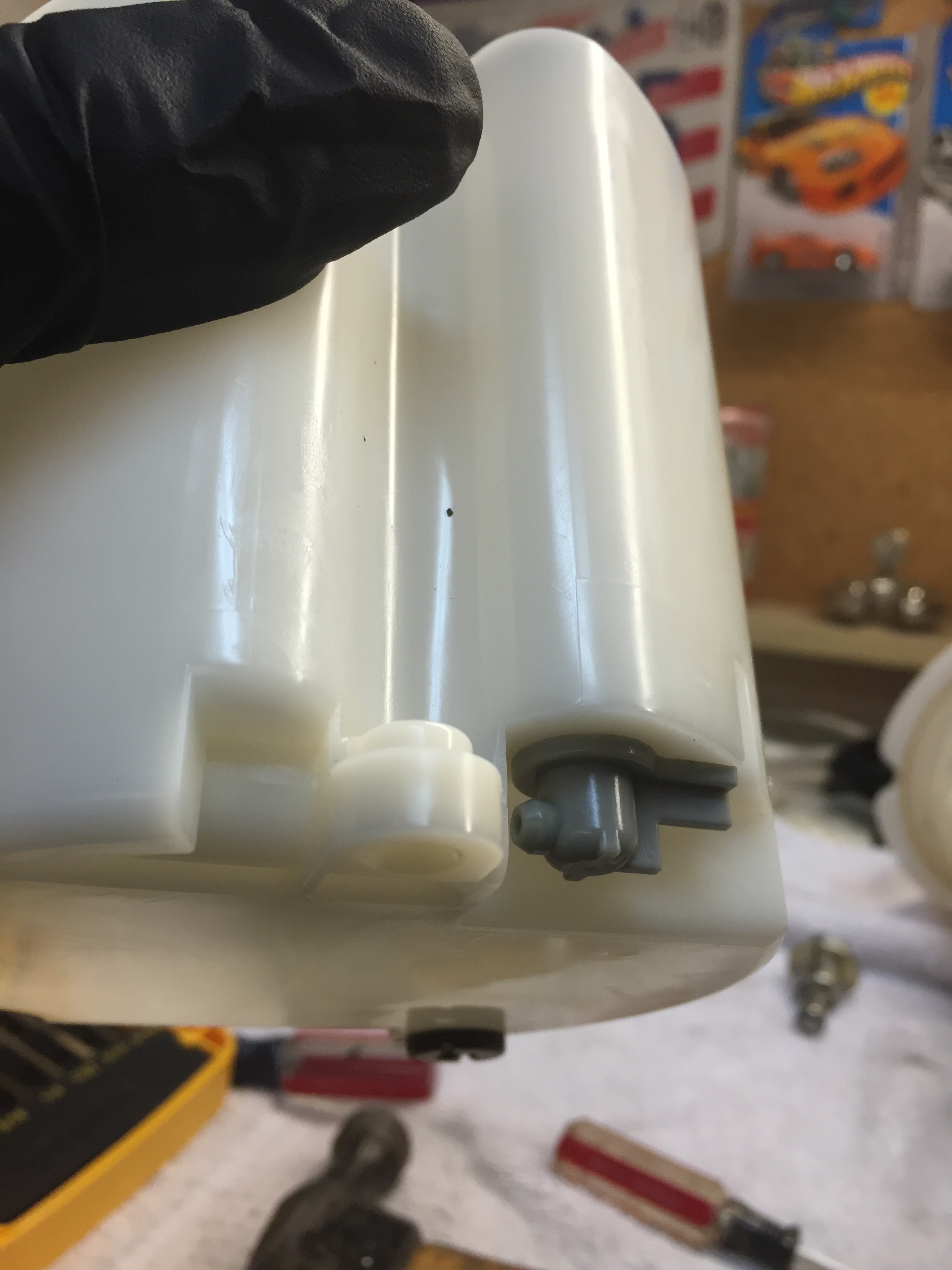

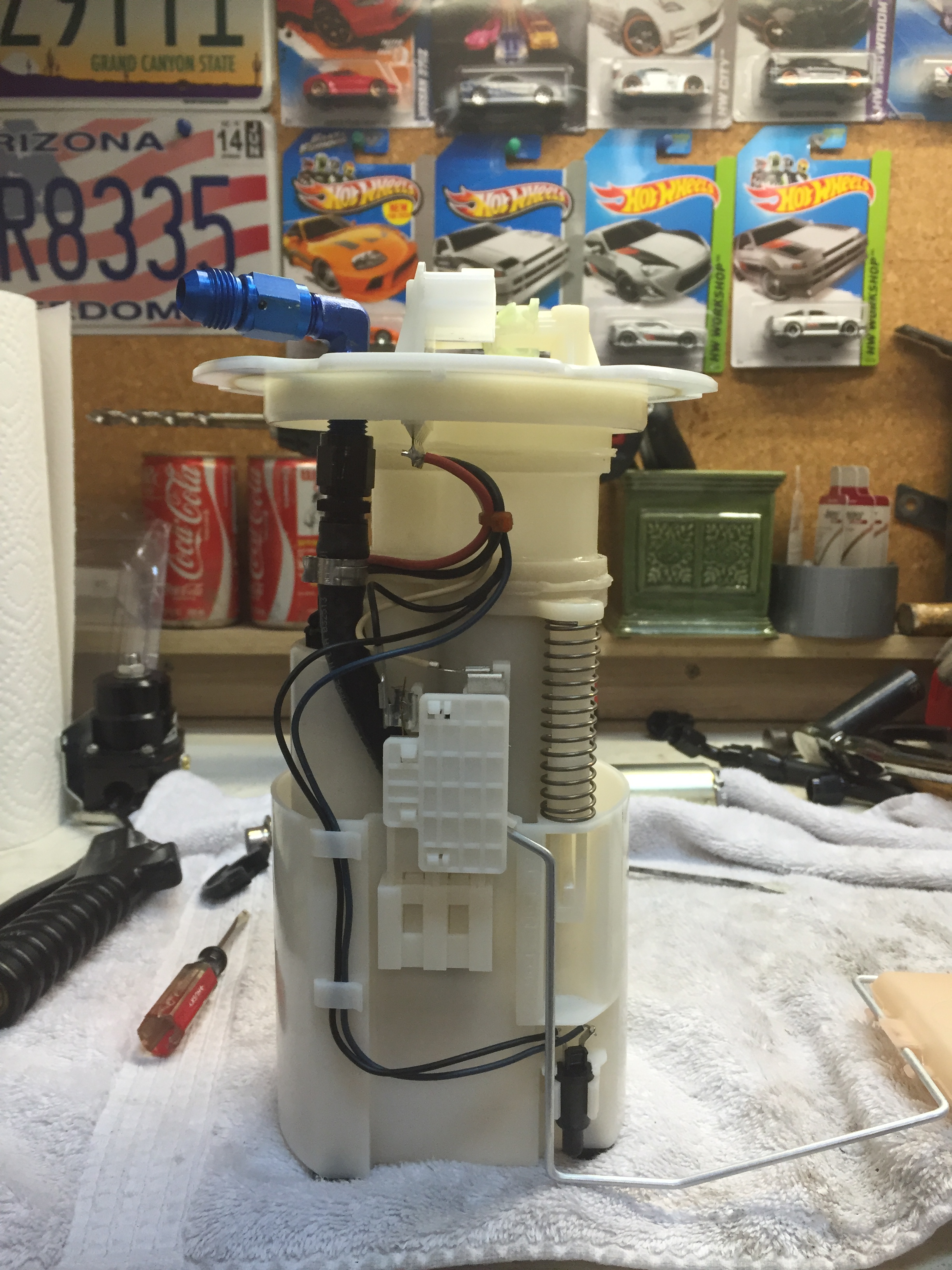

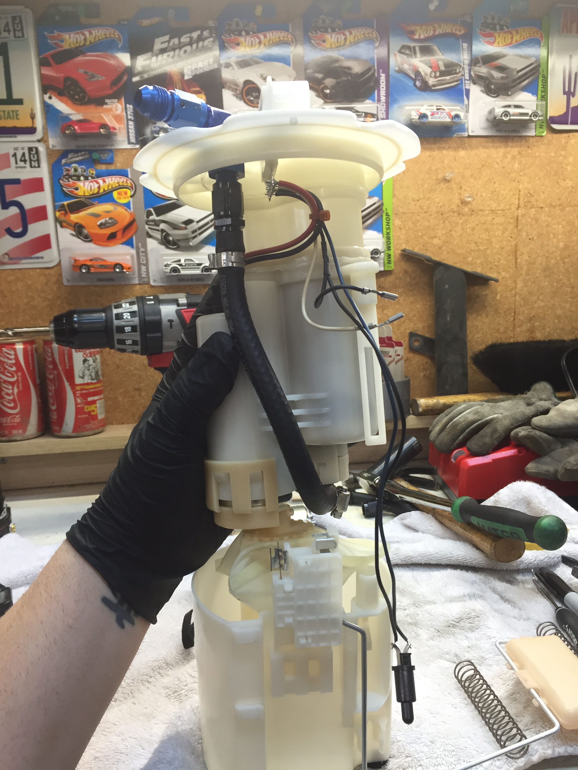

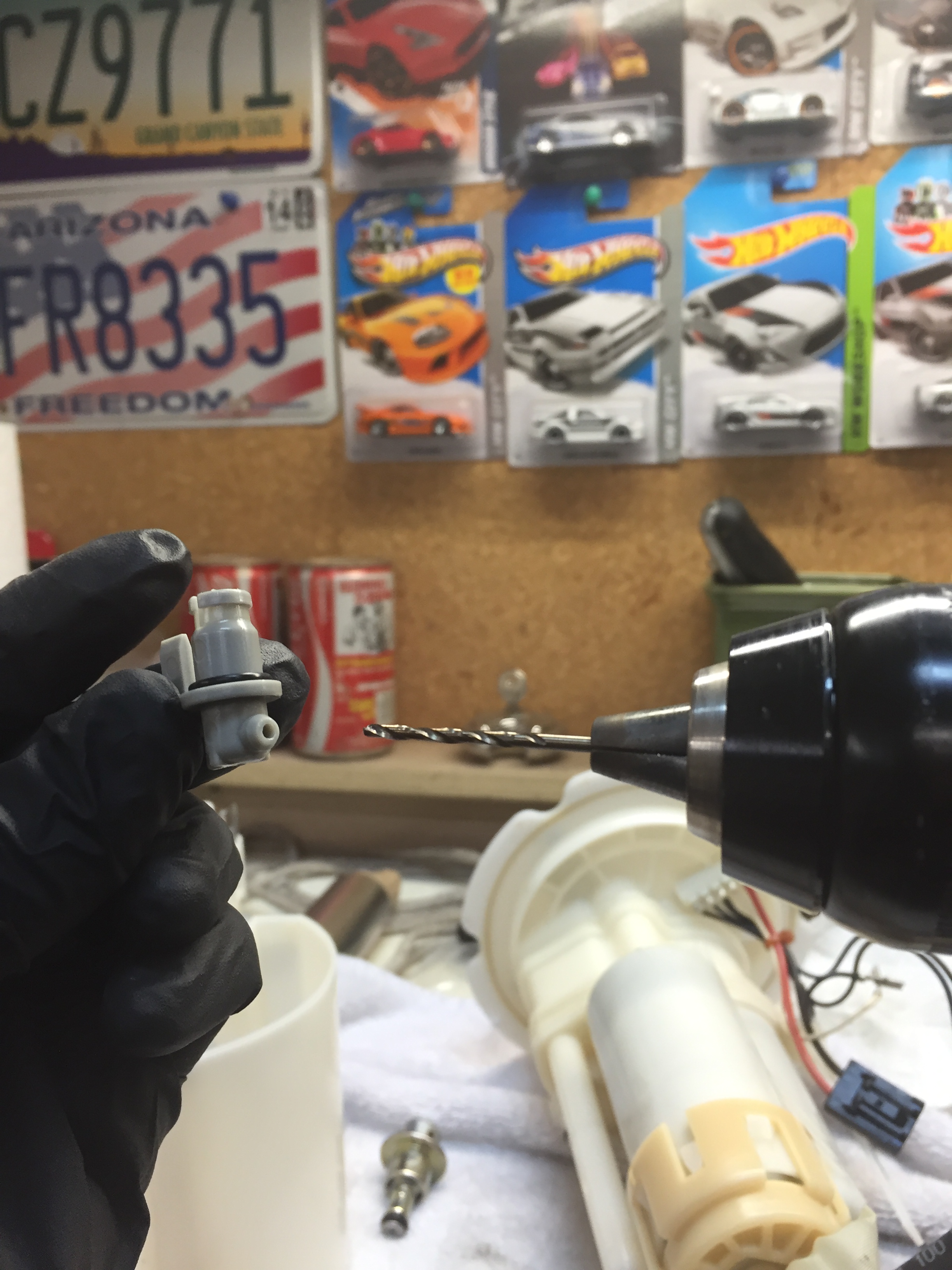

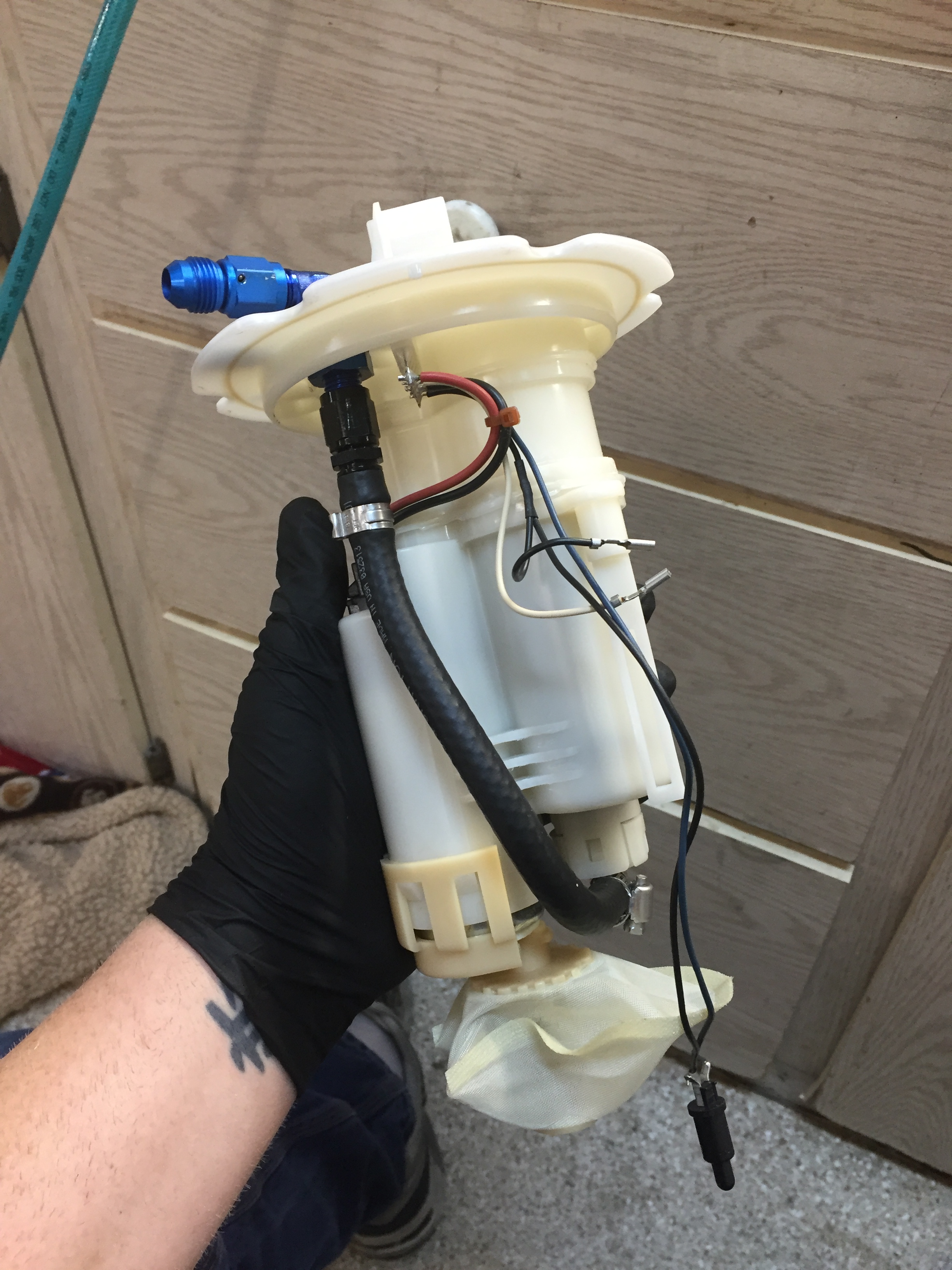

almost there... had to make the swirl jet larger to aid with a smooth idle on the return system. got the bypass installed for the regulator and starting on the actual return on the top of the basket with a AN fittin...
Attached Thumbnails #0323 az-img_0065.jpg   #0323 az-img_0066.jpg   #0323 az-img_0067.jpg   #0323 az-img_0068.jpg

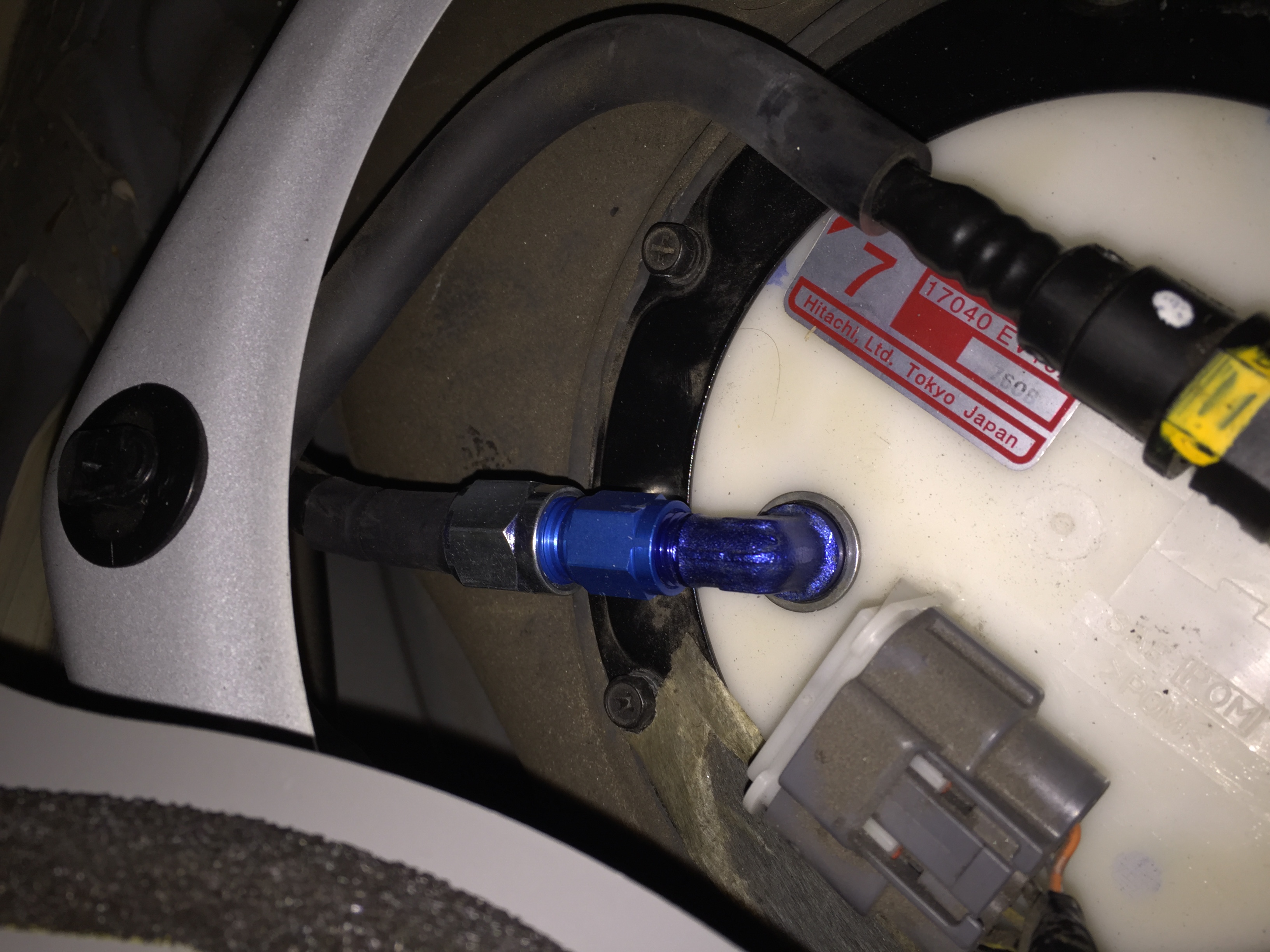

and she is all done and time for the regulator after i installed the return line along with the feed hardline under the car with zip ties. sorry i didnt get any photos of that break time cause i was thirsty...

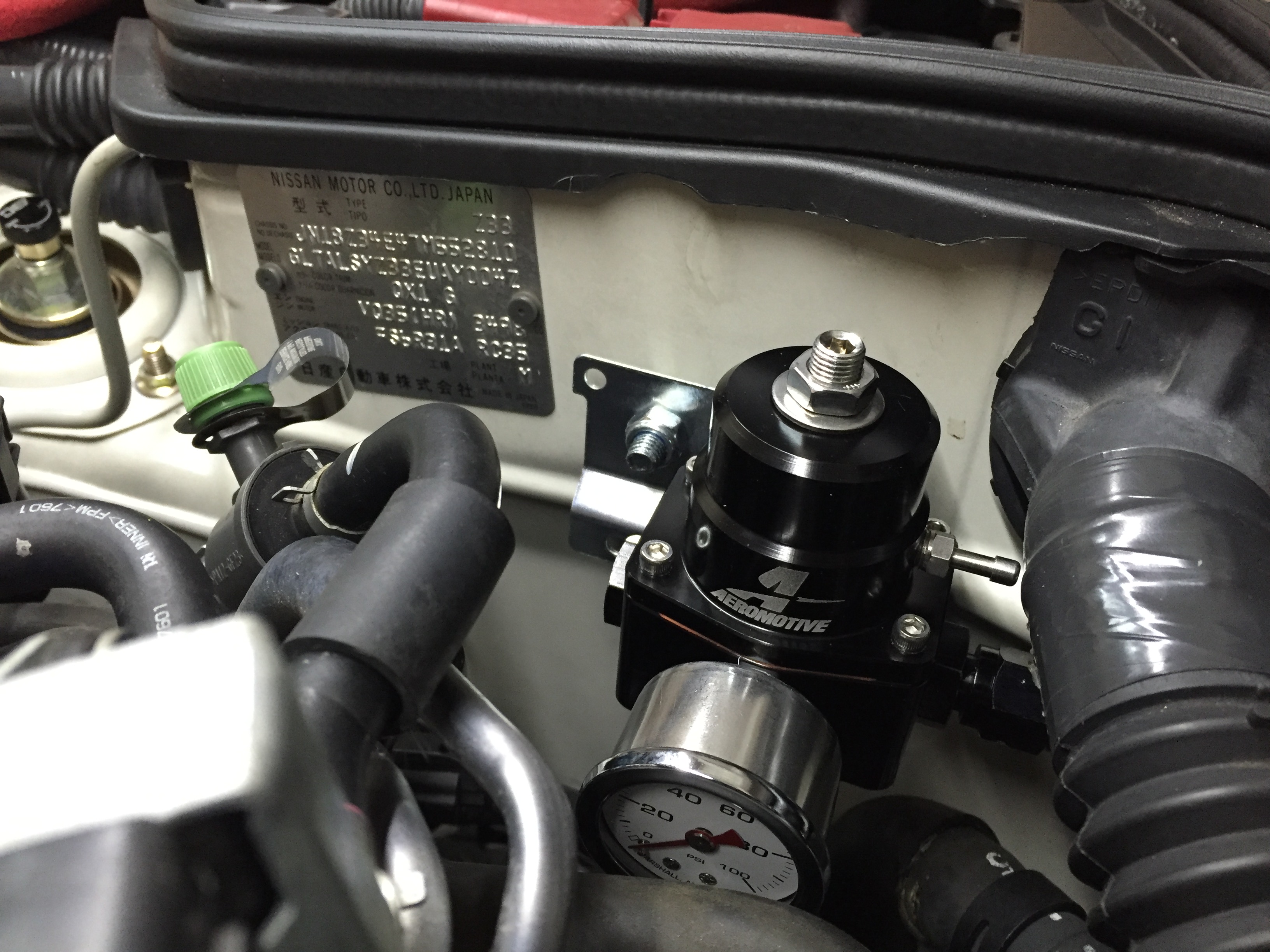

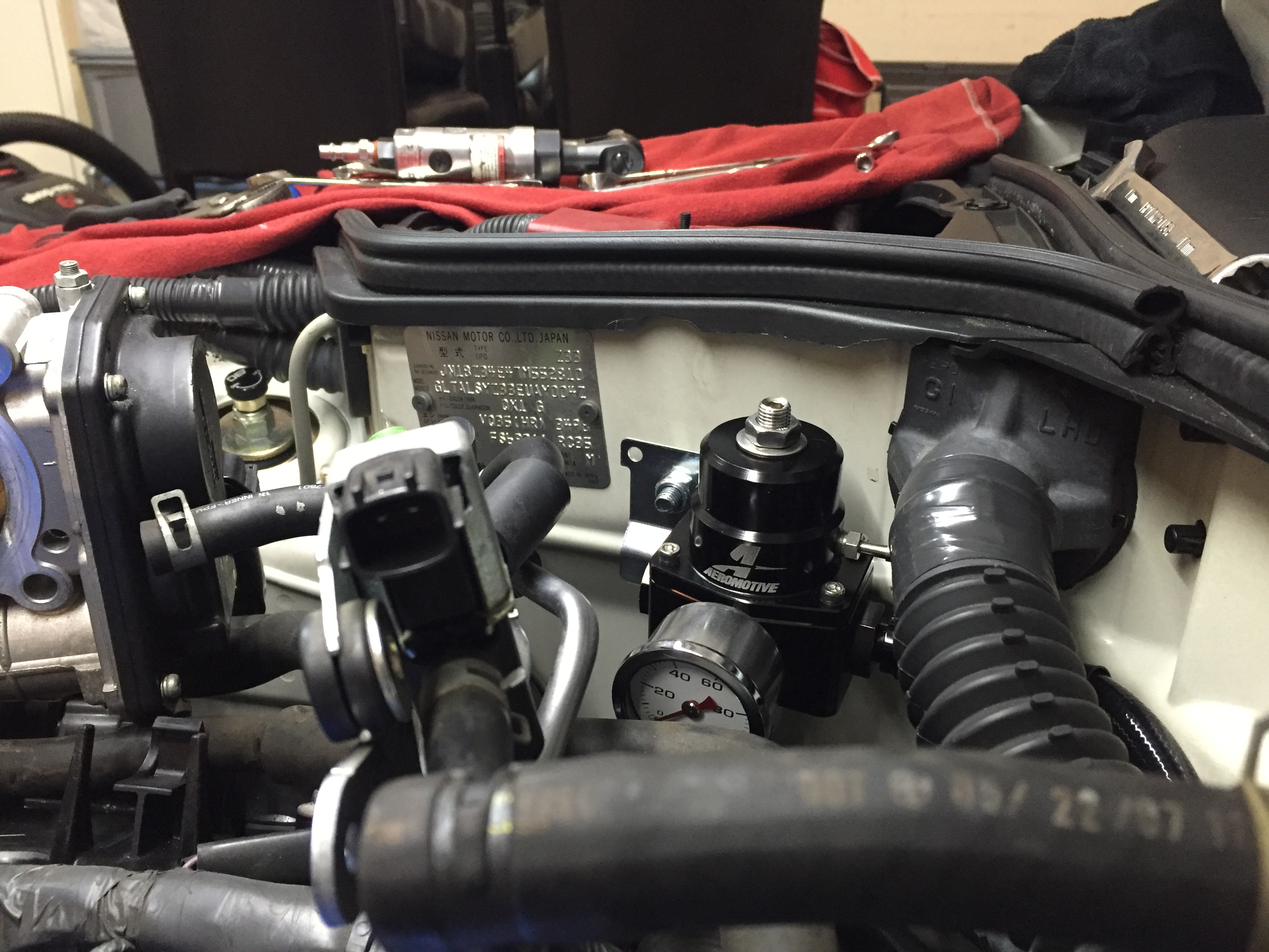

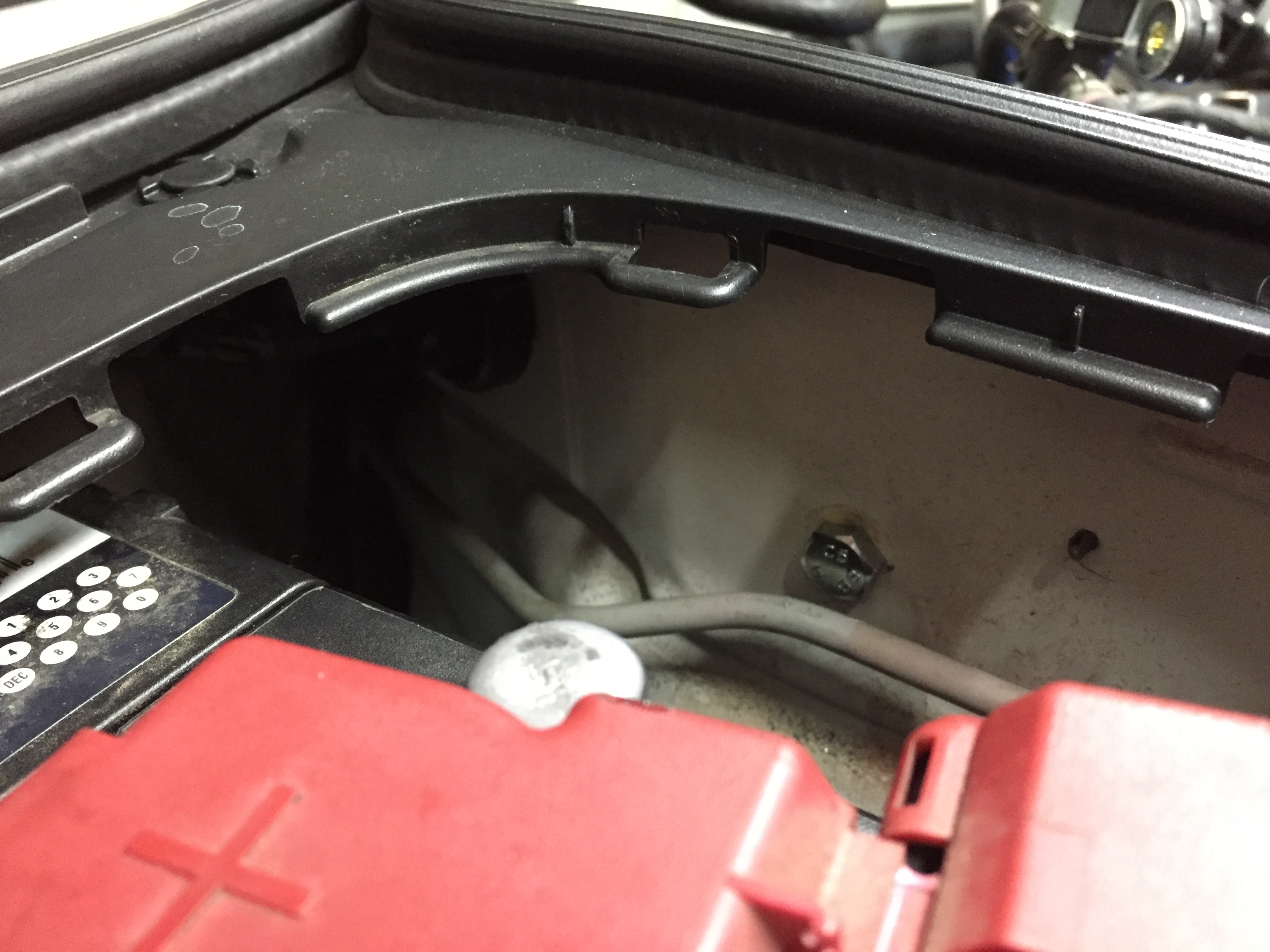

i mounted my regulator in a different spot only cause im **** about it being a nismo and i didnt want to drill holes in the back of the firewall. I used a existing hole thats for a plastic clamp for the hardline going to the brakes behind the second firewall where the battery is... i put a bolt and nut there after drilling a hole through the regulator braket that it comes with and moved it over using just one hole to mount it. once tight it was all good and didnt move anywhere....

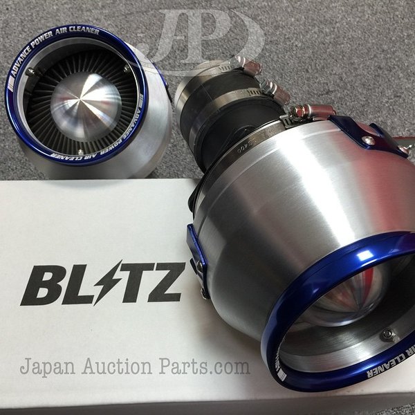

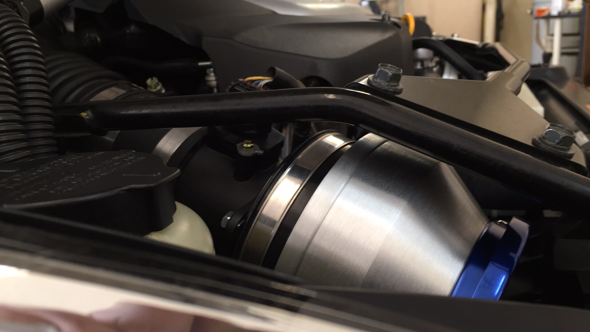

after everything was put back together and primed the new walbo 255 pump i installed and everything checked out good with no leaks. i put everything back and installed some new blitz intakes to feed the new cams. these things seriously breath!! they look like they dont, but man they breath very well. intakes scream under full load lol.
