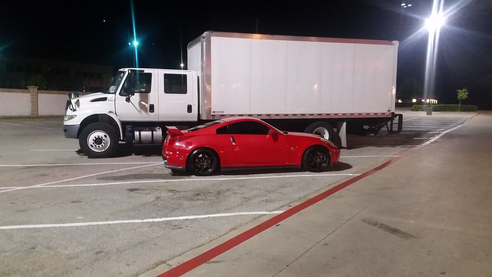

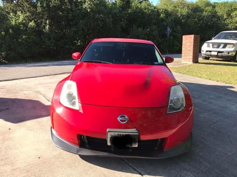

Here are some pictures of the Nismo as she was...
Here are a few pictures from cleaning her up, and out and about...
