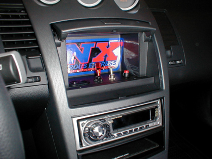

I've got 4 switches too. Here's where I put mine. The wiring was insane back there but everything fit ok. I wired the bottle heater to the cig lighter so it turns off when the car does as a safety measure. The other switches get their power straight from the battery.
Old Apr 9, 2004 | 12:49 PM
cyberz350's Avatar
cyberz350
Posts: 1,208
From: Irvine, CA

it only fit 3 switches....barely. i had to put the bottle opener switch next to the tcs on/off switch. the change thing does close all the way without hitting anything.

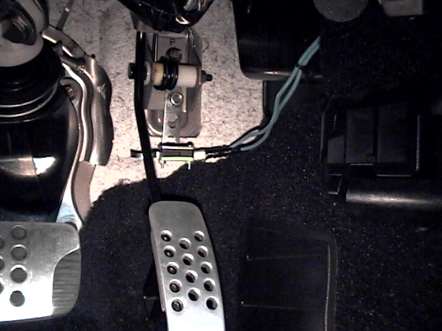

I have NX brand. Yes I am talking about the wide open throttle switch. I am thinking that maybe our gas pedals are electronically controlled and I need a TPS (throtle position sensor switch). I cant seem to find anything that moves near the intake when the pedal is pressed.

our throttle is electronically controlled. you'd have to install the WOT switch behind the gas pedal. you'll have to rig it a bit to make sure it only activates when your at full throttle.

Either will work! I prefer the TPS but whichever you use, don't forget to use a relay in the circuit.
