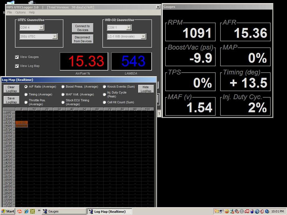

I got my innovate A/F system and UTEC to now talk to my computer and send me info so I can log in a display and street tune with ease. Here is a pic example. This is awesome.

that's awesome. Street tune time! Which innvovate are you running? In my 02 celica I was using the simple lc-1 and logworks. Then having to change the values in the emanage. A PITA for me

how did you get the Lambda feed to log? I've already got the wire ran from the gauge over to the ECU (EU days).

My Innovate has a data output and the software I use combines the signals from the UTEC and A/F.
So I use the UTEC USB output and the A/F serial. Both go to the laptop and software that can be found here combines the sig's
http://mpsav.com/MPSUTECLogger/MPS_U...r_Download.htm
http://www.jeffsoftware.com/software.php?product=UTI
I don't know which is better tho.
