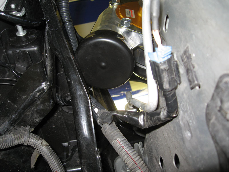

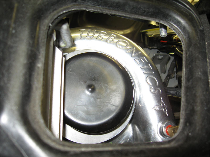

Turbonetics received my ECU today, I will probably get it back tommorow, awesome but.....
Serious hurdle we are up against now. This hasn't been that bad of an install up to this point,I'd say were 70%ish done. There are now some SERIOUS TURBO alignment issues!!! We are done until we figure it out. I will post more pix SOON!!!!

Sorry to hear about the issue, how far is it off? Possibly mis-machined somewhere in the piping?

What is it that is not lining up? You may have to reclock the turbo. Do you have pics of the mis-alignment?

I guess they said mis-machined is UNLIKLEY, thought his was my thought as well. I have no clue what to do...

Looks like if you can turn the turbo counter clockwise ( looking from the hood down) it would line up, Can you moddify that gold bracket?

Originally Posted by Abishop
Looks like if you can turn the turbo counter clockwise it would line up no?
Are you talking rotate the turbo the direction it spins (or counter clockwise to it) or turning the axis of the turbo as you are looking DOWN on it? You can loosen some bolts on the side and turn it so it will clear the headlight brace, but this wont help the alignment out the front of the car.

yea it looks like you should just reclock the turbo!
