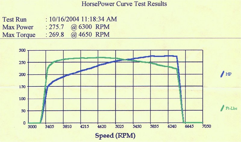

I had pulled 276hp at the wheels before my flywheel fiasco. Here is a link to the dyno chart
http://www.quiros.net/350z/dynos/101604DYNO.jpg
I didnt do a baseline, so I dont know how much improvement over stock that is, but given that most stock dynos I've seen are in the 240something range, that sounds like a 30hp improvement, which is not bad. My hesitation with the ECU reflash is that, realistically, how much more can I expect from this NA setup (cams are in the plan) and is it worth it for $600? I would reflash in a heart beat if I were running lean, since the last thing I want to do is damage the engine, but to squeeze out an extra few hps for that kind of money, I'd rather waste it on a NISMO graphics and body kit (oops, already did that )
