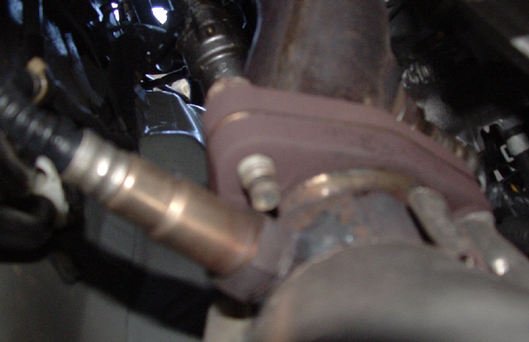

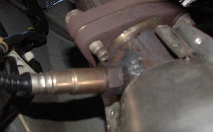

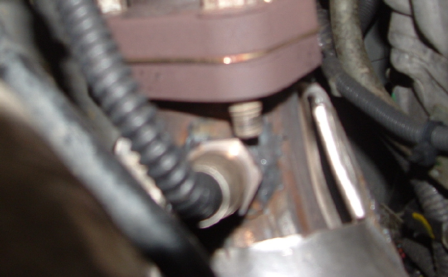

my senser installed just before the cat element
i peeled back the aluminium heat sheilding,. drilled a hole & welded a bung..

that o2 sensor isn't going to reach the depth necessary to read the exhaust flow....just a thought. your sensor is inside your spacer and not the cat exhaust inlet...don't know how that's gonna work out but let us know.

you are correct though...there is very little room before the cat. also remember to put the sensor at an upward angle. i didn't do this but it can be done if you take the cat off for the bung install. mine is pointing slightly downward but away from anything that would cause the cable to bind up
