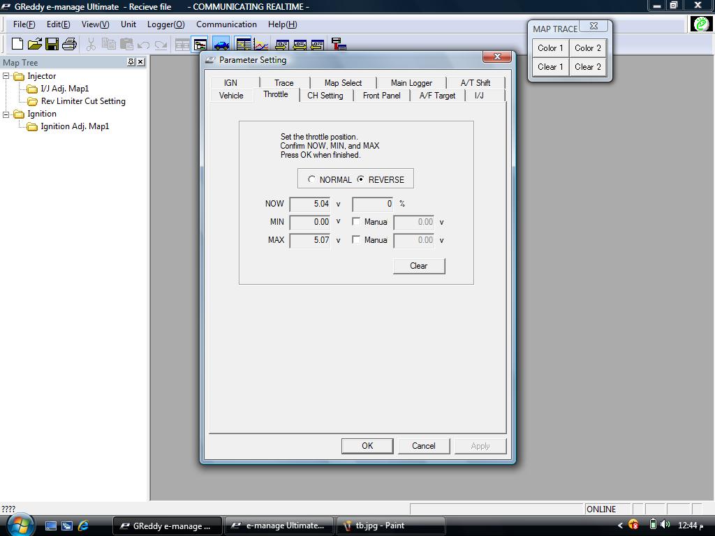

but now i want to tell what i figured out to cure this problem permanently
but one negative side we will lose any option with TB segnal
when engine want start becouse fould plugs service i went to throttel
tabe on parameters section and i tik on manually and put 5 volt on both
and apply it then engine start
as on pic but if we want to tune it
we should change scallle type on any map to use airflow voltage with rpm
insted of throttel voltage and that will help us temporarly
as on pic but if we want to tune itwe should change scallle type on any map to use airflow voltage with rpm
