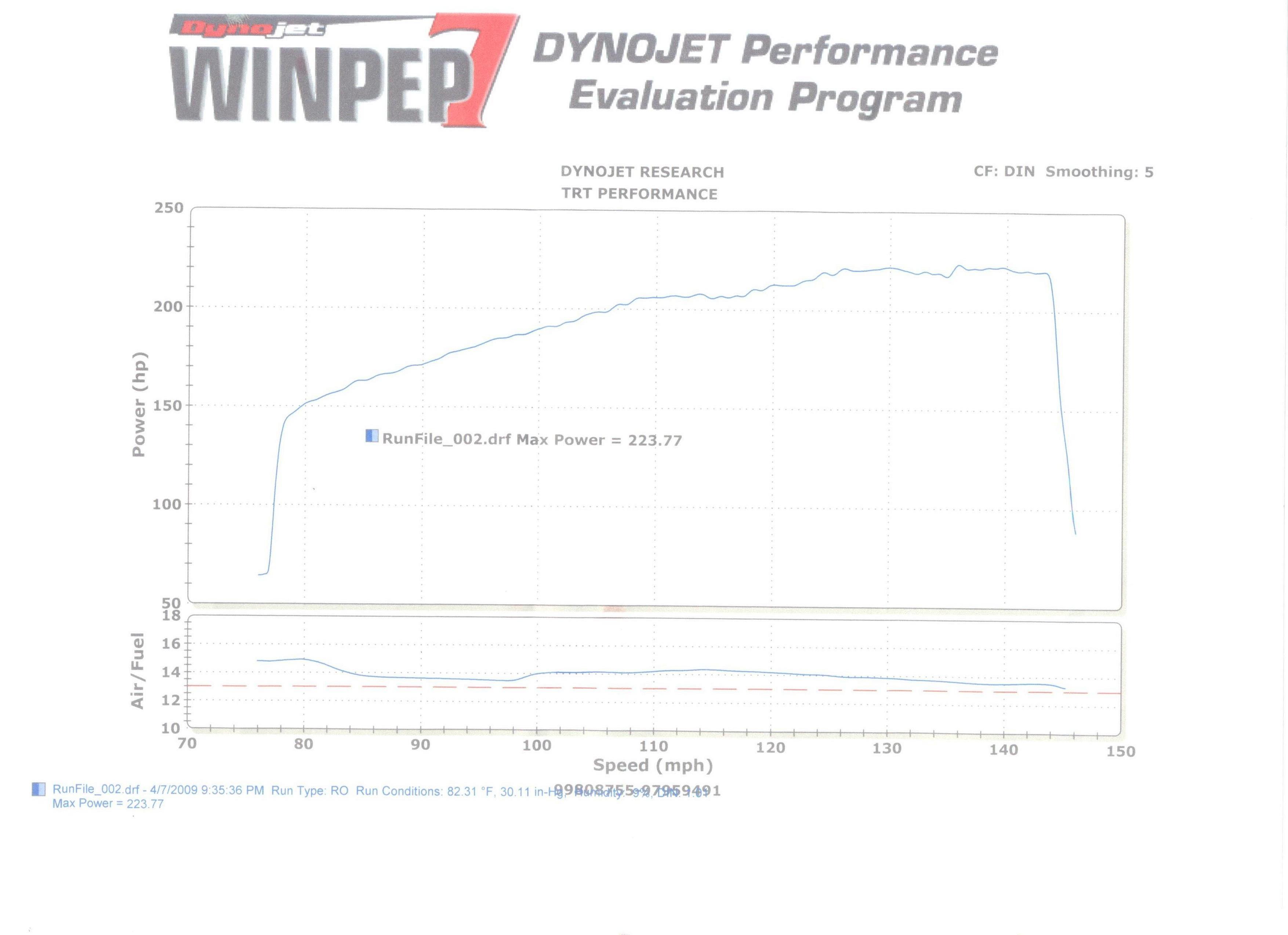

hi all ,
i need help in here ,my mod`s are in my sig and it`s AT ,i toke my Z to see how much power i gained from my base dayno (which it was also soo low 212 WHP) .
my dyno numbers came 223.77 WHP
p.s: i did dyno with aftermarket exhaust (APS2.5 TD) the numbers are 233
seeking help and advice what is wrong with my Z ?
and if Osiris would help , what should i look for in the map`s that i order ?
(e-tune ,coz we don`t have any one in here knows how to tune a 350Z with Osiris)

If you are not happy find another dyno. You’ll get more horsepower.

You gained over 20whp without an exhaust, 30whp with an exhaust and you're disappointed? Probably time to invest in a different kind of car. Either that, or it's time to understand HOW a dyno is important and how to evaluate the results. The final #'s are essentially useless, it's all about the gains. If all you want is a high #, and you don't care that the mods you put on do anything, there are any # of cars out there that will satisfy that need

That's some pretty nice gains when compared to your previous numbers.

the AF looks spot on. might be some gains from advancing the timing but proly not worth a full on tune. find someone with a Cipher and bump the timing 2 degrees and call it a day with that car.

Your running a little lean in the mid range.

Rickdogg, str8dum1, freedonutss : thank you for the helpful posts i`ll see about the AF.
Z1 Performance, 350ztttt : i wish someone would tell me where i went wrong with my post ,all i said is my #`s are low ,in here i saw many Z`s stock there #`s are higher than my HP with all my mod`s ,am i wright ?
so i thought i should ask to see what went wrong and how to fix it or this is normal ? and as far as i see in here it`s all about #`s and how much you gain from mod`s or how much is your 1/4m time ...., and if you see how much should i get from my mods it would be much more than 20 WHP over all .
and befor you give me an English lesson or tell me what to ride try to learn how to count, and say somethin usfull

If you have the DE motor, those HP numbers are fine.

You are running lean throughout but particularly in the midrange (as someone esle posted). No need to jump on other users....this is a forum and frankly they are correct, 20 wheel horsepower from those mods is very solid. There are several different reasons why your numbers could be low. Could be as simple as an incorrect correction on the dyno. 233 through an auto is not that bad. Figure you are going to lose about 2-4% more power to the wheels as opposed to 6sp cars. Yes, Osiris would help your car out immensely from the look of your chart. Don't be dismayed your car is fine.

I also thought my numbers were low but it depends on how the dyno is calibrated. I was dyno tuned with Osiris on a dynojet but the shops dynojet is known to read pretty low. Dont be discouraged with numbers tho its all about what you can do at the track. Also, at idle you want your a/f to be around 14.3-14.6 and at WOT you want to be around 12.9-13.3.

You also have an AT, which has a bit more loss than all they dynos you are referring to from 6MTs.
BTW, where is the TQ? BTW2, dynos should plot HP and TQ vs RPM with AFR. Anything else, IMO, isn't worth paying for. Sometimes the TQ curve changes are more important than the peak HP changes!

That's just it, your #'s are not low at all. They are exactly where they should be. Do not worry that your car "only" shows 213 whp stock and others show more. The #'s are basically meaningless - the gains are what is important. You installed mods and gained a significant amount of power - that means it was money well spent. If you were expecting more power relative to the minor mods you installed, then you were misinformed. The gains you got are exactly what one can reasonably expect from the mods you installed
Its more like 8%
OP...there is a member with the screen name "small tuner" who is also in Kuwait and seems pretty knowledgeable. You may want to shoot him a PM, maybe he could help you out.

Why are they using a DIN correction factor?
