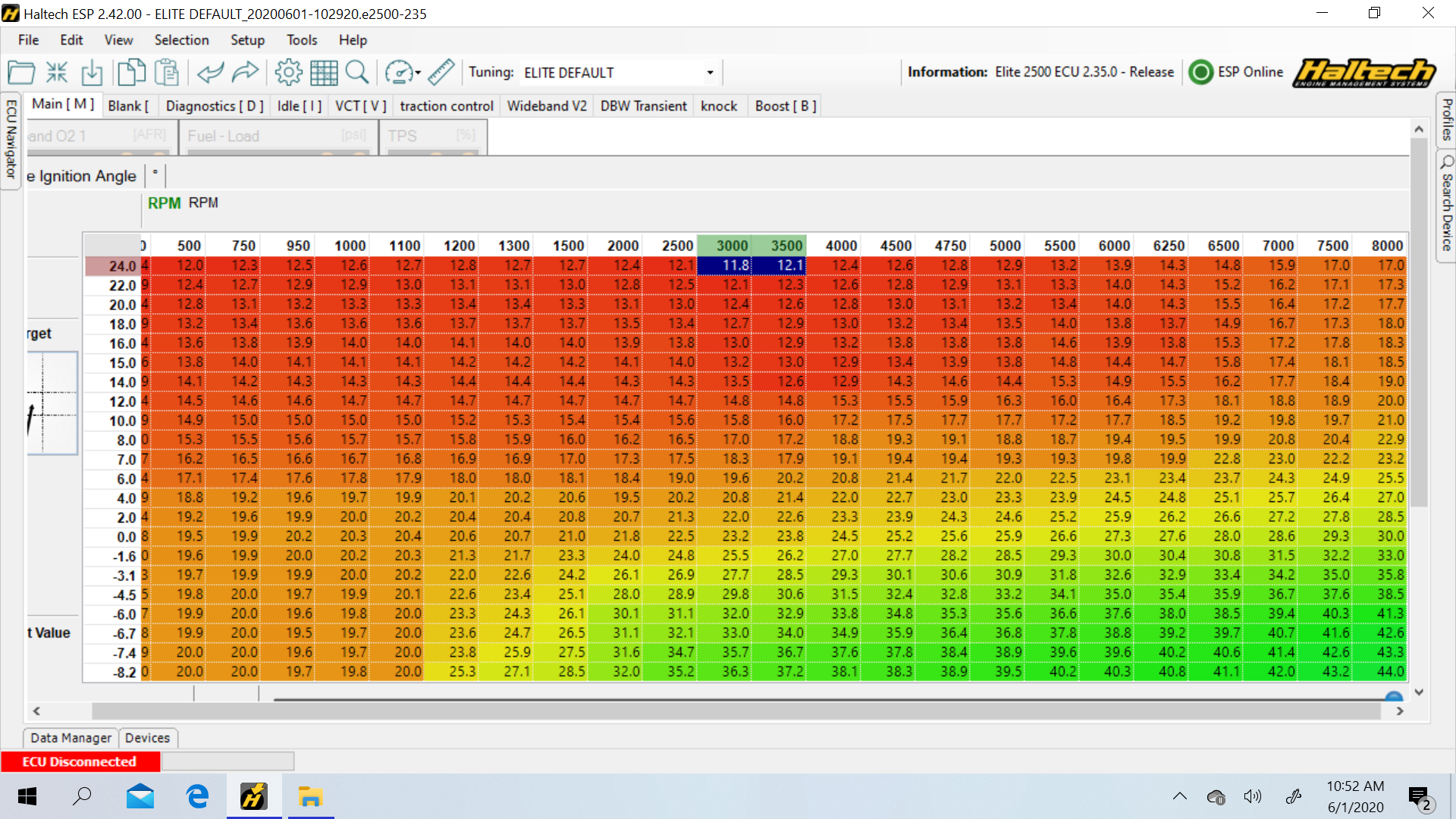

Couple of my tables if youre interested. Still need to get it on the dyno and play.... hopefully covid cooperates

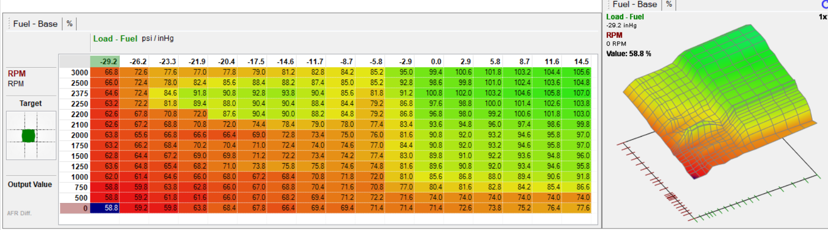

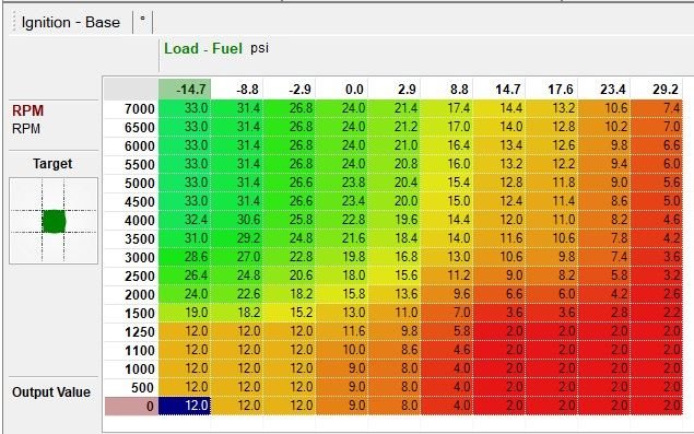

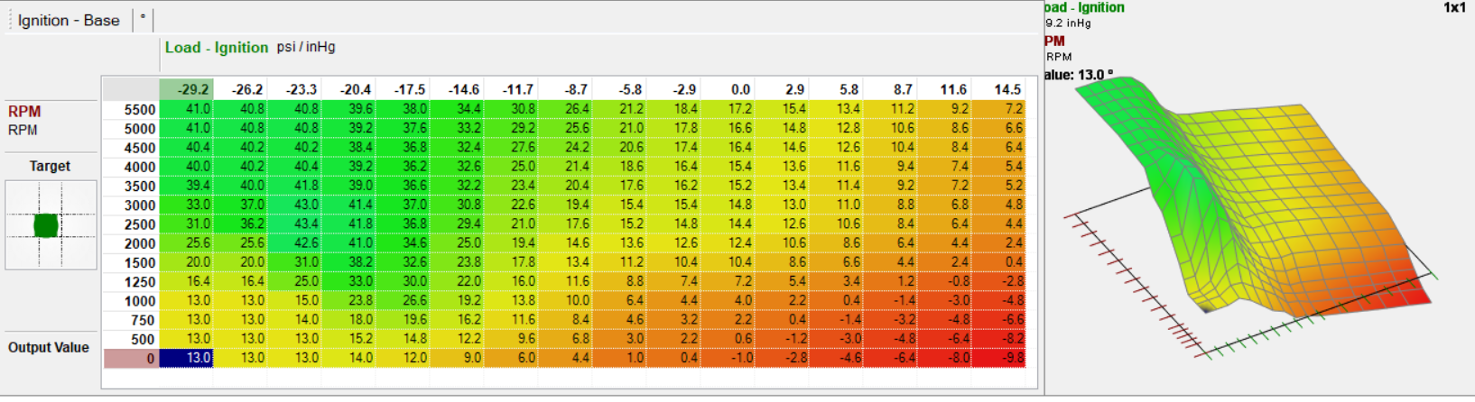

A stripper once told me: 'lots of pennies on that table' … and that's what I feel about your ign-timing map
go get tuned and definitely don't listen to a single thing I say - but here are my two timing maps for a +/-15psi tune

Ill always listen to you brother! These are just bases I built before getting on the dyno. The cars tell us what they want once there!

Whats the compression ratio of the engines for the featured maps?

I'm pretty sure those are both mine and I'm 9.1 : 1 pushing high-teens boost levels...
