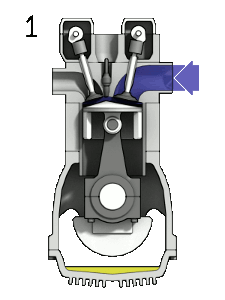

Originally Posted by bealljk
Grey - you are assigning a defination that may be correct in some context - but not in this instance
one rotation (staring at TDC) is the piston moving down and drawing in air, then moving up and compressing said air
one revolution is (starting at TDC) is the piston moving down and drawing in air, then moving up and comrpessing said air, (cue the spark & combustion event), combustion pushing the piston down, and then the piston coming back up pushing exhaust gas up and out of the valves.
Sorry to bring this thread down … please resume the lesson…
With your statement here it would mean when my tachometer is reading 7000 RPM (revolutions per minute) on the dash, each piston is actually going up and back down 14,000 per minute... Is that your understanding @bealljk ?

Im not sure how exactly the tachometer relates to the crankshaft rotation - I dont know that answer.
In terms of engines - one engine revolution is 4 cycles (suck, squeeze, bang, blow) which is differnet than one rotatation of the crankshaft.
Thats a good question -
I think (after talking to a few car buddies/truck nerds) in reality, the tachometer doesnt measure revolutions (in the 4 cycle sense). It’s measuring rotations. A little misnomer in that the tach is measuring revolutions. So maybe Uprev is right!!!!!!
When your tach says 7000 RPMS, it means your crank is doing ONE 360* rotation 7000 times in one second. Its dumb i know they are mixing the lingo.
100% wrong Conway…
7000 times in one minute! Lol…just give you ****…

Originally Posted by Dr Hoon
I feel dumber for having read this discussion.
RPM refers to revolutions or rotations of the crankshaft per minute, the terms are synonyms.
The camshafts in a 4 stroke engine revolve at half of the crankshaft speed.
At 7000 RPM crank speed the camshafts do 3500 rotations per minute and therefore there are 3500 full cycles (intake-compression-combustion-exhaust) per minute.
Completely agree. Rotations and revolutions are synonymous.
Cycles are equal to cam revolutions and are half the crank revolutions.
not to beat a dead horse but synomous = yes … same thing = no …
