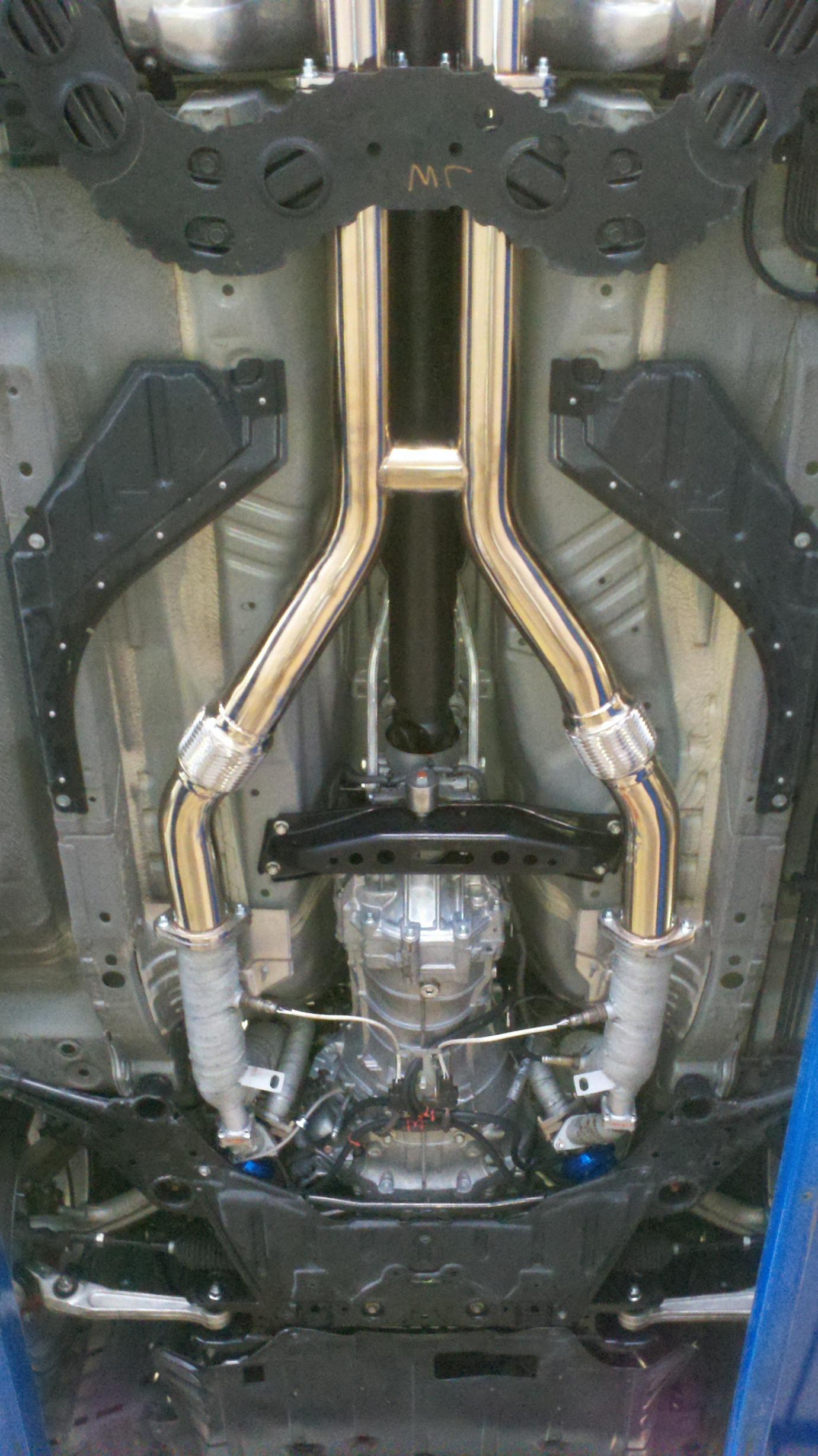

I have been lookit at a ST kit for the HR guys, and have not been able to find a donor car. While going through a lot of pictures I found this one:
I would just like to confirm that the HR cars (2007-2008) have this opening right after the transmission (yellow circle).
This is where the turbo goes on the VQ35DE (03-06) cars, so I thought with different header flanges the kit would fit, at least as far as all the exhaust components, and turbo intake go.

I don't know for sure, but I'll check later today.

Here's some old pics from under my '07. Don't know if you can really see it from these but they were just some I had in my photobucket and like I said I will get under it and check later (after the game).

It is there on my 2007. Do you want some pics?

Thanks for all the pics guy. In most of them the skid plate blocks the view of that area though. Something under the car in that spot would be great.

Maybe these will help?
Attached Thumbnails Single turbo possiblity-2011-10-24_11-34-56_863.jpg   Single turbo possiblity-2011-10-24_11-34-38_455.jpg
