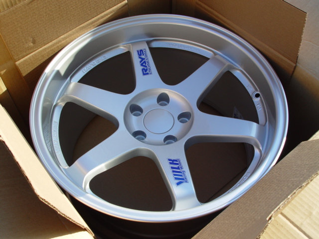

hello 350z group,
well, i had a lot of e-mails regarding what sizes and offsets fit the 350z for the volk racing te-37:
here ya go.
17 inch:
standard- front 8 33mm rear 9 22,28mm
lowered- front 8.5 30mm rear 9.5 38,35mm
18 inch:
standard- front 8.5 30mm rear 9.5 35mm
lowered- front 8.5 22mm rear 9.5 22mm
special- front 9.5 22mm rear 10.5 22mm
19 inch:
standard- front 8.5 29mm rear 9.5 34mm
lowered- front 8.5 22mm rear 9.5 12,22mm
special- front 9.5 22mm rear 10.5 22,35mm
hope this helps,
john

Here's my question: With the 22 mm offsets and 9.5 width rears, will the rear fenders need to be rolled if I don't lower the car?
Thanks for the great info....your car looks awesome. I have a PPW track model and I'm drooling over your wheels. Any idea if the tire pressure sensors will work with these wheels?
Old Apr 13, 2003 | 08:02 PM
john350Z's Avatar
john350Z
Posts: 1,223
From: sactown, cali
jfive-next mod maybe is nismo kit. what do you think?
zztop-no rolling of fenders needed if not lowering car and with 22mm rears. also, yes-tire pressure sensors work on wheels.

What do you mean "special"? I would like to put 9.5 front and back, although I think I'm leaning toward the SE37K or CE28N for weight. The SE37K comes in 18x9.5 28mm. Do you think this will work in front with or without spacers?

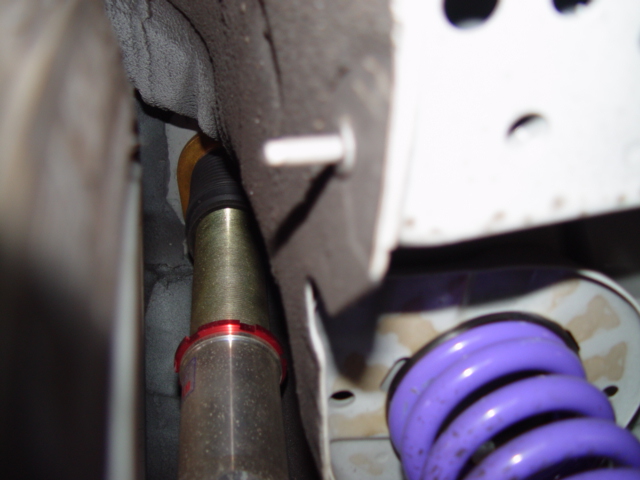

So for the 10.5 inch 22mm wheel in back, you had to roll your fenders or else it would rub, right? How's the clearance from the inside of the rim to the shocks? I'm just curious as to how a 10.5 inch rim would fit back there. Snug or is there more room available for wider wheels?
Old Apr 16, 2003 | 11:35 AM
john350Z's Avatar
john350Z
Posts: 1,223
From: sactown, cali
mrb,
it's a snug fit and yes i had to roll the rear fenders.
here is a pic of the rear driver's side.
Attached Thumbnails volk te-37 fitment answers for anyone purchasing-silver-te-37s.jpg
