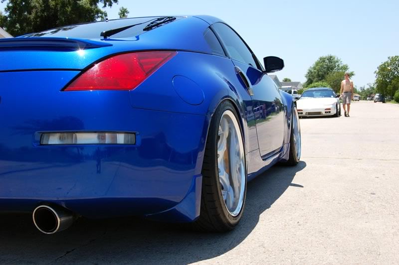

Here are a friend's GTS's on my car. They are 19x10.5 +18 with a 285/35/19, a 10.5 +18 extends 15mm further than a 9.5 +20. I believe it will clear easily given 15mm and a smaller tire.

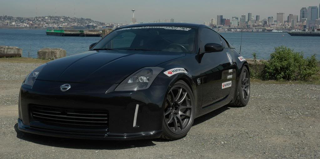

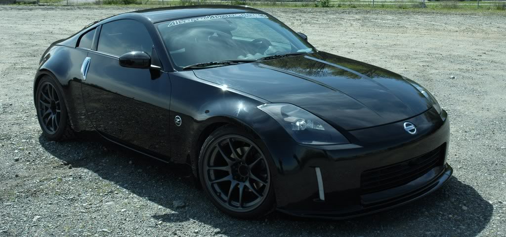

Pics courtesy of first350. He's running 275/35/18 with 18x9.5 +20 rears and fenders aren't cut/rolled. Looks like it clears easily to me.

Yes my fenders are rolled. (the blue car) I know every tire is different but to go and just say "it won't fit" is incorrect. I believe first350 is running BF Godrich KDW tires 275/35 not 275/40.

The black Z is running 9.5+12's, the blue Z is running 10.5+18's, that means an extra 7mm of clearance for the 9.5's, even though the offset is lower. RT-615's and KDW2's are probably the only 2 street tires that will rub on this setup. I run a 9.5+30 wheel with a 285/35/19, and with a 20mm spacer I still clear. Currently running a 25mm spacer with a roll, and I could easily push it to a 30mm spacer for a 9.5+0, and my camber is only at -1.6. You made it seem like any 9.5+12 setup with a 275 will "rub like crazy" when that just isn't the case, the majority of 275 tires will clear, you just happen to be using one of the wider 275's. that was my only point

Redlude, the black Z is running 18x9.5 +20 so it's another 15mm or clearance when compared to a 19x10.5 +18
