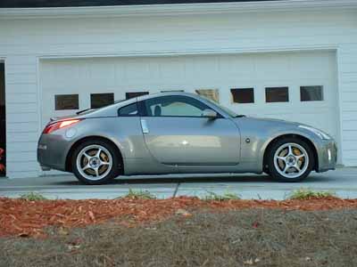

this is what it looks like, but these are my track only tires, not street rubber. If you are planning on lowering with springs, don't do it, as the springs tend to lower the rear more, and with the same size tires, the rear is already lowered to level the car.
