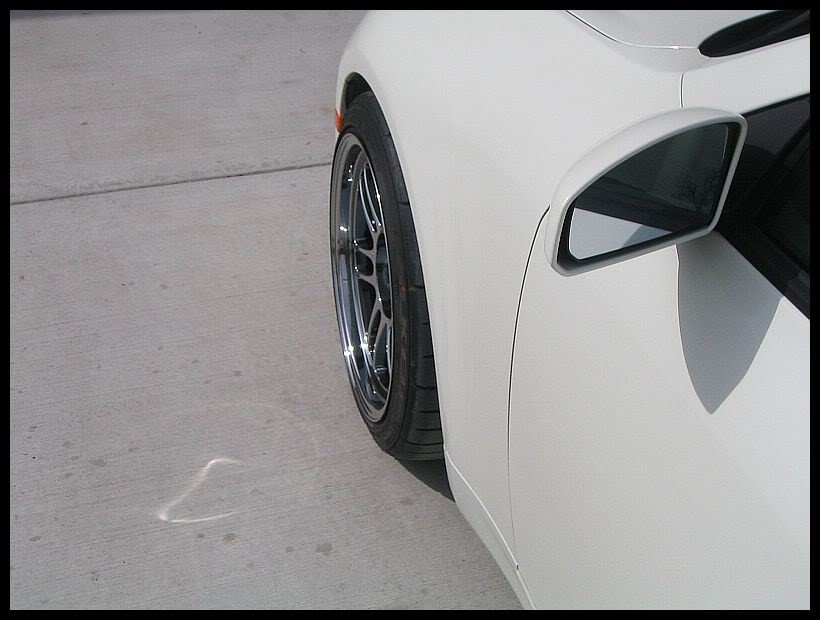

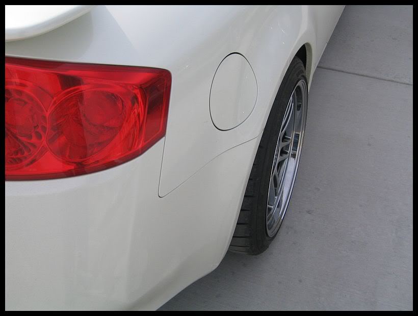

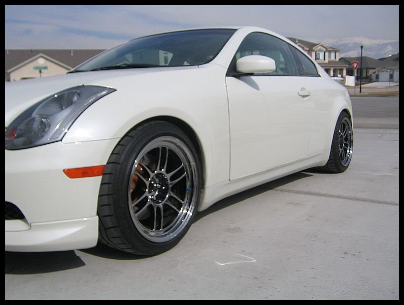

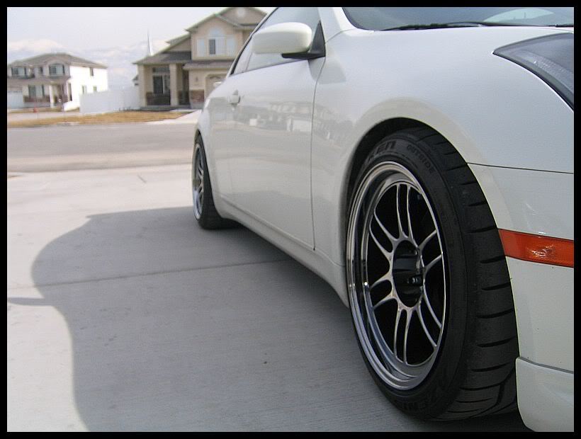

yes you will have to roll your fenders.
all of this depends on your drop and the amout of camber you run!
- 18x10.5 +15 w/ 265/35/18 Falken Rt-615's
- about -1.75 to -2 degrees of camber
- Zero rubbing and zero fender rolling
- Stance coil-overs
*I dropped the car more after the pics so it was totally flush and still had no rubbing. Now from my experience is that G35's fenders are a little more "roomy" so you may need fender rolling depending on your setup. Hope this helps
