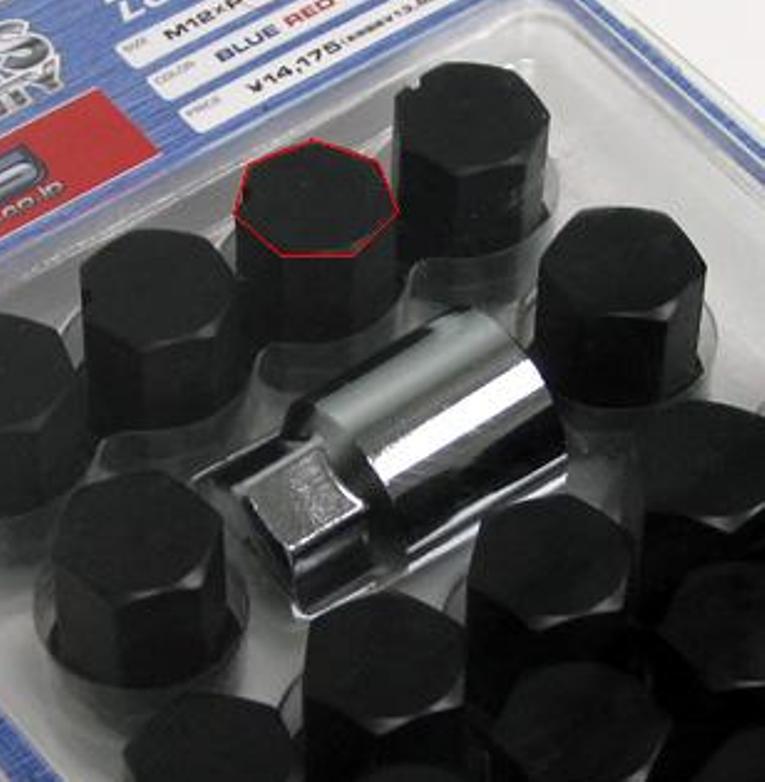

The locking lugs actually have 7 sides. The rest are normal 6 sided lugs. I highlighted the 7 sides on one of the lugs in red. I also lost my key and just used a 3/4 inch or 19mm socket and hammered them on to bust them off.

i think all the rays have the same damn lock. so all of us with rays can go around steeling each other's rims!! haha..i believe (not to sure) if you use a 12 sided socket might do the job of taking off that 7 sided "locking" lug. If you think about it, most of us tq the lugs down by hand to about 75 lbs. IF someone really wanted the rims them broke lug nut remover's will do the job with ease. So i dont even know what the damn purpose of the "locking" lugs are for these days.

There are 3 different orientations to rays locking nuts. The diagram posted above is the
center orientation - the other two are left and right of center. I destroyed my lock key
(mostly bc its a piece of ****) and had one sent overnight by evasive motorsports for
$24.95 or so about a year ago. Good luck.
