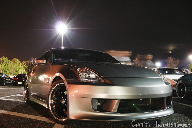

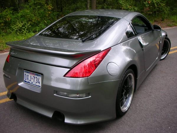

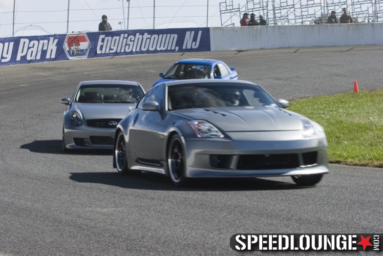

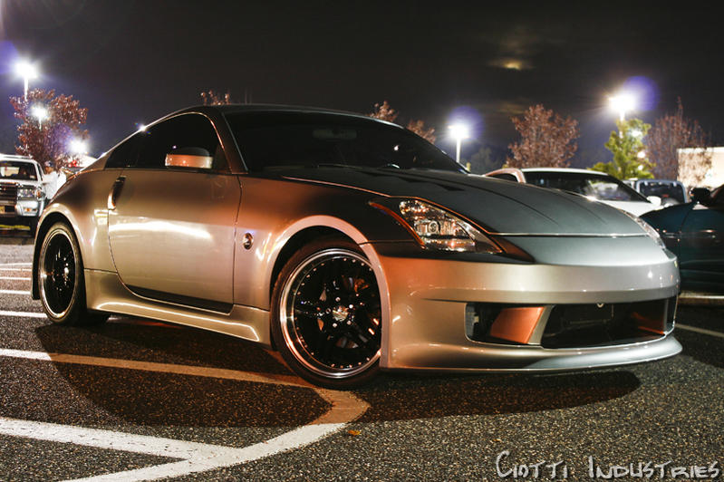

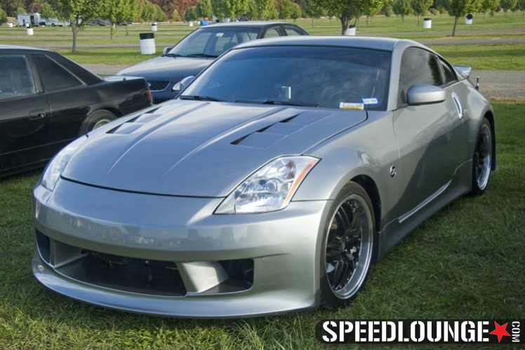

So i have 19"X 8.5 and 19"X9.5 with +35 mm offset, to me they look like they sit in to much and i dont want that lowered honda look with the wheels sunk in when i lower it. I want an agressive right to the edge of the fender look. I was thinking about going with the Project Kics +15 mm spacer. Please help, and i did look around for the answer. Oh and with the spacer will that make my offset +50? or +20
